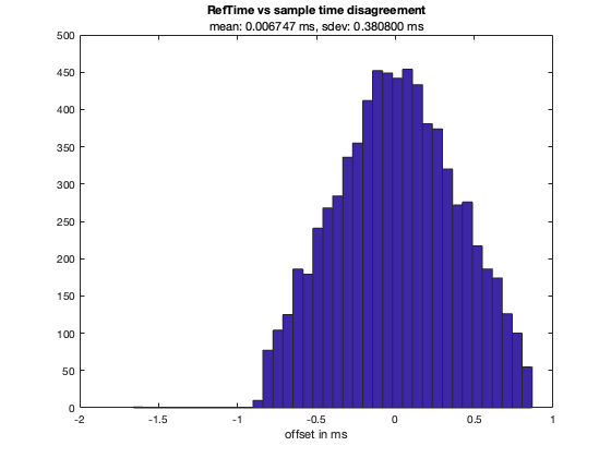

Data recorded with SignalGenerator source module
As one may see from this graph, event time stamp disagreement from sample position is within +/-0.5 ms, so the Event time mechanism is working close to perfectly.

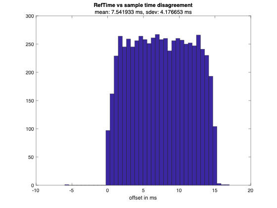

This graph shows that there is quite some disagreement between sample time, and event time. This is due to the fact that SignalGenerator is not a true data source, and uses the imprecise Windows Sleep() function to simulate regular arrival of sample blocks.

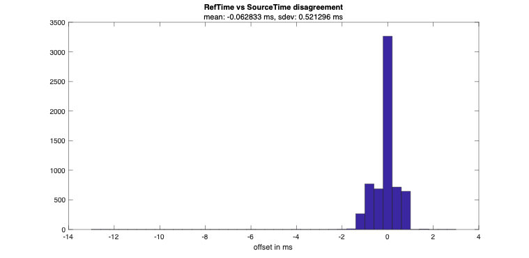

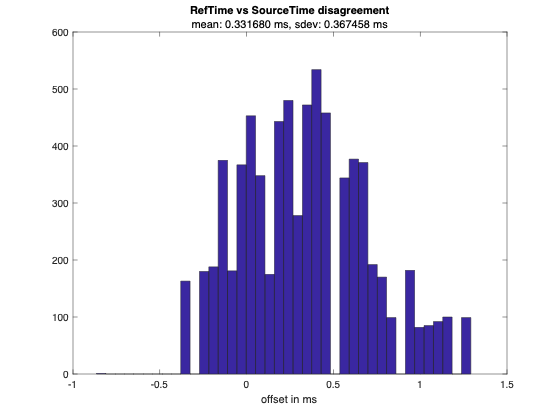

Data recorded with g.USBamp source module
Similarly to the SignalGenerator example above, the Event mechanism is working close to perfectly with the g.UBSamp amplifier, with a jitter of +/-0.4 ms (standard deviation).
When comparing event time stamps to sample time for data recorded with the g.USBamp amplifer, we have a nearly perfect distribution of differences, with an event timing jitter of +/-0.4 ms (standard deviation).
Note that time stamps are rounded to full milliseconds, so an event timing jitter in the order of half a millisecond is to be expected.
