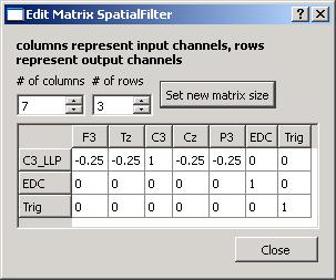

How do I get to this interesting window? The plethora of tools without a common GUI still confuses me at times. As far as i know, the Matrix itself should be stored in .prm file accompanying the recorded data. What tool did you use to display and change the matrix? Where does that fit into modifying filters for offline use?boulay wrote: Most BCI researchers use a simple linear kernel as an approximation of a Laplacian spatial filter. See the attached screenshot. You can ignore EDC and Trig. Also, that should be T7, not Tz. -Chad

I use \BCI2000\tools\BCI2000FileInfo\BCI2000FileInfo.exe to load a data file, then I click on View Parameters.TokyoBCI wrote: How do I get to this interesting window? The plethora of tools without a common GUI still confuses me at times. As far as i know, the Matrix itself should be stored in .prm file accompanying the recorded data. What tool did you use to display and change the matrix? Where does that fit into modifying filters for offline use?
The new window is the same as the GUI for the BCI2000 operator Config menu. If you've ever used BCI2000 for online feedback of brain signals then you have probably encountered this window.
You can modify the parameters as you see fit, then click on "Configure Save..." to choose which parameters you want to write to the .prm file, then click on "Save Parameters..." to write the prm file. In the future, you can also use this window to load a .prm file, make some modifications, and then save it again. If I only need to make one simple modification then I simply use a text editor to edit the .prm file. If I need to make several chnages, and if I can't remember the exact format for the line of text, then I use this tool.
I'm not sure about the loss of channel labels. I use full matrix spatial filtering and yet I can still access the signals in my application module by name (instead of index).
