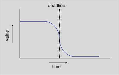

In computer science, real-time computing is the study of hardware and software systems which are subject to a "real-time constraint”, i.e., operational deadlines from event to system response.
By contrast, a non-real-time system is one for which there is no deadline, even if fast response or high performance is desired or even preferred.
  • Deadline requirements vary, e.g.
continuous classification -> hard deadline
incremental evidence -> soft deadline

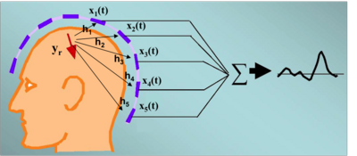

Beamforming is a technique to extract source signals from a multi-channel recording. In this hands-on tutorial, we will use an adaptive spatial beamformer to compute a biophysically motivated source projection which is adapted to data covariance.
Adaptive Spatial Filtering
Region in the brain: r
Forward model: H(r)
Assumed neural activity: yr(t)
Model for the projection of the source to the channels (forward model H):
x(t) = H(r)yr(t) + n(t)
Estimate the strength of activity of the neural tissue at location r < / math < < math > sr(t) = w(r)Tx(t)
sr(t) = w(r)TH(r)y(t)
