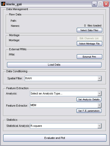

After having run mario.exe, press "Select Data Files".
A dialog window will ask you to select the dat files. You can either select a single data file, or select multiple files. This time, we will select all files in the dataset.
A green box will surround the Raw Data box in the main window.
As an optional (but recommended) operation, click on the LOAD MONTAGE button and choose the mmf file. This will allow you to see the labels of each channel and allow you to apply spatial filters that depend on the electrode position.
You can load an additional parameter file with choices different from those used in the experiment.
At this point, you can check that P300 is selected in the Analysis menu (indicating that a P300 dataset has been recognized) and select the LOAD DATA button to confirm your choices. This will enable the EDIT CHANNEL LIST button that you can use to select the channels you want to include in your analysis.

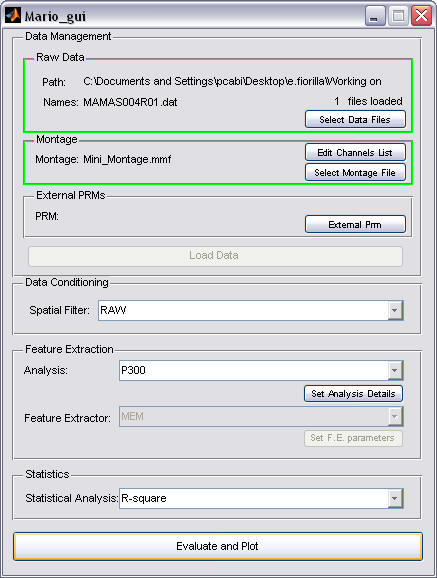

The Analysis field in the Feature Extraction panel will appear automatically depending on the files loaded. The Feature Extractor field shows the only currently available option (MEM). You can view/edit analysis details by clicking "Set Analysis Details"
This form reports all the remaining settings for the P300 analysis. Most of the values are set as default values. With settings such as the ones reported in this figure, the analysis software will:
  • sample the spectrum at points starting from 0.1 Hz to 15 Hz
  • take a 650 ms long epoch of data.
You can modify these settings according to your aims. When you are finished, remember to confirm your choices by clicking on DONE. It will allow the program accept changes.
At this point you can start the analysis by pressing the Evaluate and Plot button.

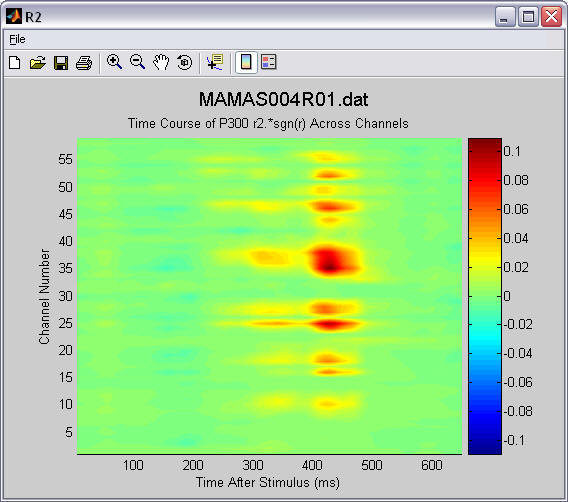

The first figure that appears is the R-square matrix (channels x elapsed time after stimulus)
R-square Matrix
The r-square matrix highlights the most relevant ERP features for the separation of potentials due to frequent or rare stimuli.
Each row of the matrix is related to a single channel, while a column represents a fixed latency. The color codes the statistical significance of the difference between the two kinds of evoked potentials.
Thus a red color would mean that the ERP consequent to a rare stimulus is significantly more positive than the ERP consequent to a frequent stimulus.
This figure is independent of the channel and latency settings that were set in the parameter dialog (since it summarizes all results).
Clicking on the matrix will modify the channel/latency settings for the other figures; in fact the cell of the matrix that was clicked is characterized by one channel and one latency, whose waveform and topography (respectively) will be shown in the other two figures.

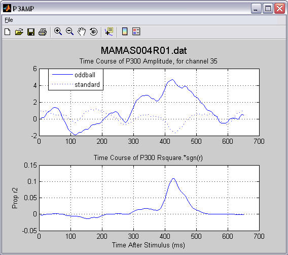

Amplitude Waveform
The whole timecourse of ERPs generated are displayed in the top panel, regardless of the specific stimulus (line of letters) that generated it. Rare ERPs are plotted in solid lines, while frequent ERPs are dotted. If two channels were selected in the P300 parameter dialog, they are plotted in red and in blue, respectively.
The bottom panel shows the r-square time course. It is roughly proportional to the difference between rare and frequent ERPs, but since r-square is sensitive to the dispersion (variance) of single trials, small differences in amplitude can result in a high r-square, if they are very reproducible.

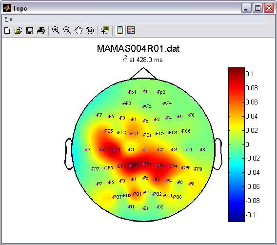

Topographic plots. This figure represents the scalp distribution of the r-square.
The color coding is the same as the r-square matrix figure, and values on each channel are interpolated to create a continuous bidimensional map. The higher the number of electrodes, the more accurate is the map. With Surface Laplacian spatial filteriing, the number of channels shown on the scalp may not coincide with the whole number of electrodes, since the value of the laplacian is not computed on the border channels.

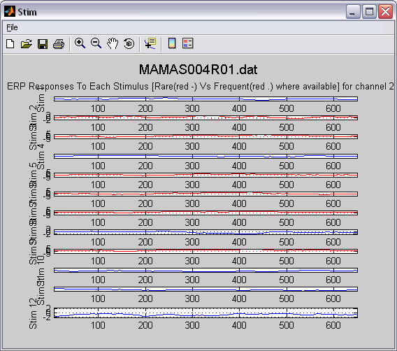

ERP Response
The figure shows the medium temporal course for the 12 stimuli. Red graphs are rare events while blue ones are frequent events.
