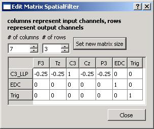

boulay wrote: Most BCI researchers use a simple linear kernel as an approximation of a Laplacian spatial filter. See the attached screenshot. You can ignore EDC and Trig. Also, that should be T7, not Tz.
-Chad
How do I get to this interesting window? The plethora of tools without a common GUI still confuses me at times. As far as i know, the Matrix itself should be stored in .prm file accompanying the recorded data. What tool did you use to display and change the matrix? Where does that fit into modifying filters for offline use?
I also wonder whether the bci2000chain.m covers only the Signalprocessing module between (but not including) the Alignment Filter and the Connector Input or whether one needs to specify the lot to get usable data in the end. Which is it?
The bci2000wiki states that dense to full matrix spatial filtering will result in loss of channel labels.
How is it possible to use just the moving average filter used by the p300temporal filter? Is there an isolated form somewhere?
Posts: 382
Joined: 25 Dec 2011, 21:14
Re: Locating the Filters in BCI2k
Post by boulay » 08 Aug 2012, 05:45
TokyoBCI wrote: How do I get to this interesting window? The plethora of tools without a common GUI still confuses me at times. As far as i know, the Matrix itself should be stored in .prm file accompanying the recorded data. What tool did you use to display and change the matrix? Where does that fit into modifying filters for offline use?
I use \BCI2000\tools\BCI2000FileInfo\BCI2000FileInfo.exe to load a data file, then I click on View Parameters.
The new window is the same as the GUI for the BCI2000 operator Config menu. If you've ever used BCI2000 for online feedback of brain signals then you have probably encountered this window.
You can modify the parameters as you see fit, then click on "Configure Save..." to choose which parameters you want to write to the .prm file, then click on "Save Parameters..." to write the prm file. In the future, you can also use this window to load a .prm file, make some modifications, and then save it again. If I only need to make one simple modification then I simply use a text editor to edit the .prm file. If I need to make several chnages, and if I can't remember the exact format for the line of text, then I use this tool.
I'm not sure about the loss of channel labels. I use full matrix spatial filtering and yet I can still access the signals in my application module by name (instead of index).
