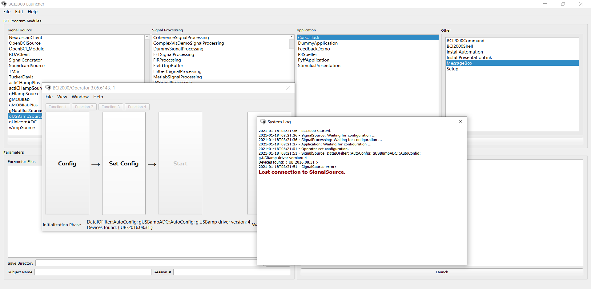

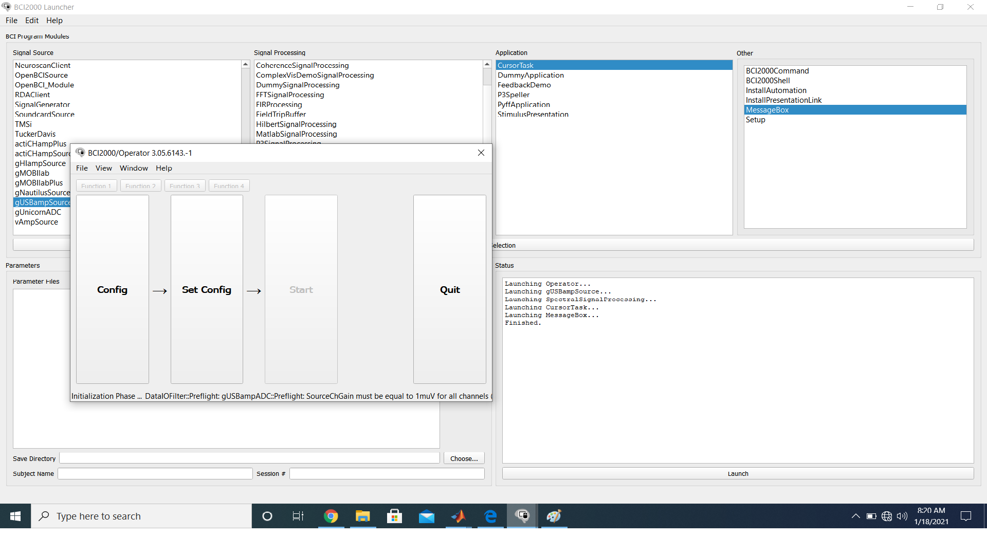

Thank you very much for your reply and actually latest update solved this issue but now I am facing a new issue. BCI2000 recognizes the usbamp yet the moment I click set config it gives an error saying "Lost connection to Signalsource". Kind of similar to the issue talked about under this discussion but I am not trying to create any module viewtopic.php?t=3405
Please see attached screenshots
- BCI2000 issue first ss.png (137.67 KiB) Viewed 43582 times
- BCI2000 issue second ss.png (75.25 KiB) Viewed 43582 times

It appears that either somehow you are mixing executables from different distributions, or that your distribution is broken.
Have you tried compiling from source?
