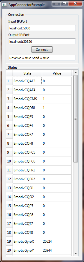

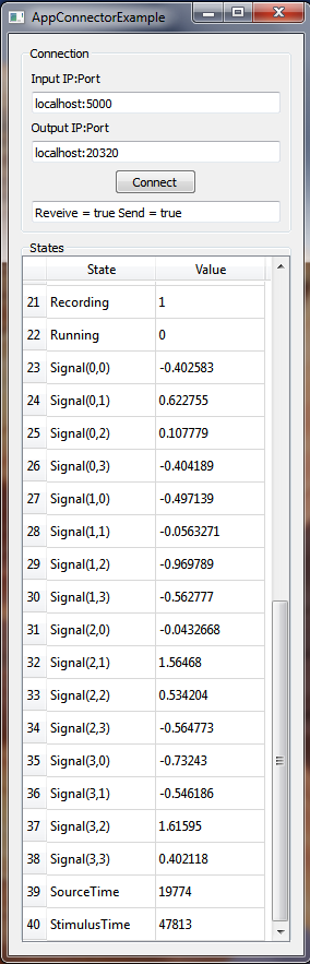

I suppose that the KeyStateFilter is the easiest way to start, get some more experience and later I can see how to improve the workflow and make it more error-proof. But how to start? I read the User Reference:States page, but do not really get it. I do not understand the DAT files when I open them in Notepad, nor what to type in the KeyStrokeStateName field in BCI2000's Application-tab (I suppose I should connect it to a State there, but how to instruct the system what keypress to perform).
I attached two screenshots of the AppConnector GUI with the state names I encounter when using the Emotiv device in combination with the Mu intro session. Can you give me an example on how to proceed, how to use them focusing on the KeyStrokeStateName field?
Suppose I want to associate "moving the mouse up" with sending key "0" to my robot arm control app, how should I start?

How can I know what e.g. Signal(2,1) stands for? I understood that in Signal(A, B) the A-value might be related to a direction (X=0, Y-1, Z=2) but do not know whether that is correct (and what X=3 then means in my AppConnector output). Besides, how to know what the B-value means? E.g. why do you use Signal(2,1) for Cursor Up? And what do B=2 or B=3 mean then?

The content of the control signal is defined by the LinearClassifier filter (http://www.bci2000.org/wiki/index.php/U ... Classifier). A signal's first index is called "channel", and its second index is called "element". The LinearClassifier does only write a single element into its output signal, so there is no element index other than "1".
Feedback-based application modules, such as the CursorTask or the FeedbackDemo, take channel index 1 to represent the x dimension, 2 to represent the y dimension, and 3 to represent the z dimension. In the tutorial, the brain signal is used to control the y dimension. Thus, Signal(2,1) is the only value that contains information about the brain signal. Also, the sign of that value determines the direction of cursor movement. For more information, please see the CursorTask documentation:
