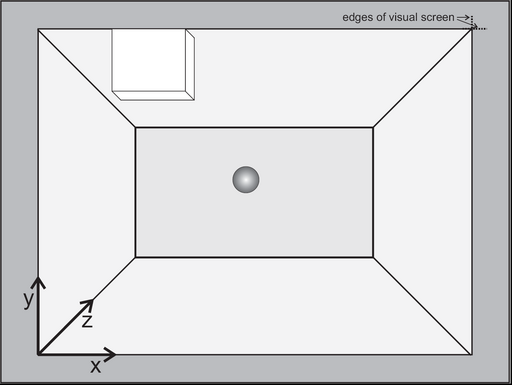

Visual Representation
The visual representation of the CursorTask consists of a 3-dimensional workspace that can (if selected) be indicated by five bounding rectangles. These rectangles can have a user-selectable texture, which is the same for each rectangle. Targets are represented by cuboids, whose edges can also have a particular texture. Finally, the cursor is represented by a sphere. It also may have a user-defined texture. To facilitate depth perception, the cursor's color provides an additional cue about the cursor's Z position as follows. The operator specifies the cursor's color at the topmost and at the bottomleast Z positions. For any color between these extremes, the cursor's color will be linearly interpolated between the two colors. (Specifically, each of the three color components (i.e., red, green, and blue) will be interpolated to result in the cursor's color for a given Z position.)
Control Signal
Cursor movement is controlled by the output of the Signal Processing Module. In this signal, channels 1, 2, and 3 correspond to dimensions X, Y, and Z, and there is a single value (element) present in each channel, defining cursor speed in the respective dimension.
Additional channels or elements that might be present in the control signal will be ignored by the CursorTask application module.
