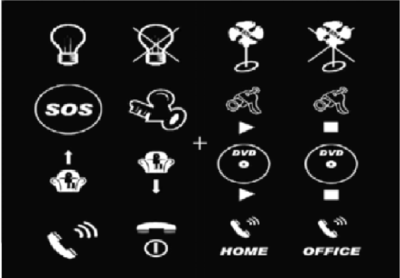

I read article talk about bci & home appliance ... & I want to realise the same work to controle a domotic home by using a 4x4 matrix that allowed a total of N=8 stimulus classes.
and in the middle of this matrice I want to put a fixation cross.... The fixation cross was static in the middle of
interface and never flashing, also during stimulation. how can do that????? :shock:

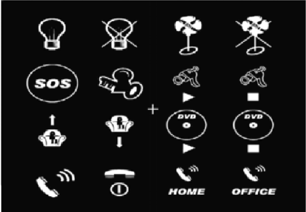

stimulation interface composed of several icons... stimuli consisted in an intensificatin of rows and columns. a no flashing fixation cross was placed in the center of the screen
The GazeMonitorFilter can do that for you:
http://www.bci2000.org/wiki/index.php/C ... itorFilter
