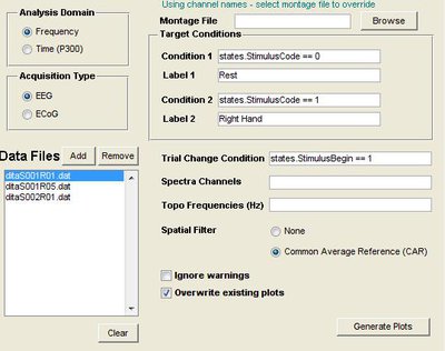

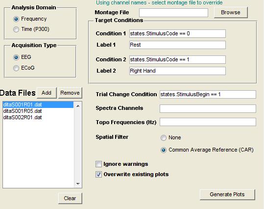

1. i use offline anaysis like this

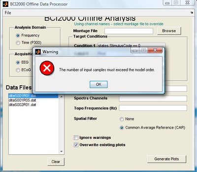

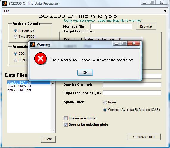

but, when i write states.StimulusCode == 0 , i've some error like this picture
can you tell me, what should i do? thanks
Re: setting cursor task 3D to 1D
Post by mellinger » 24 Jun 2013, 11:47
the error message says that you don't have enough data for the condition StimulusCode == 0. You will need to increase the inter-stimulus-interval (ITI) of your stimulus presentation to fix that.
