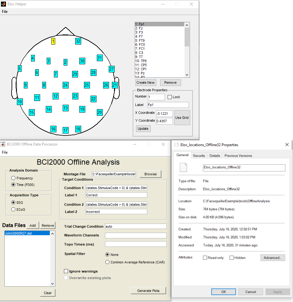

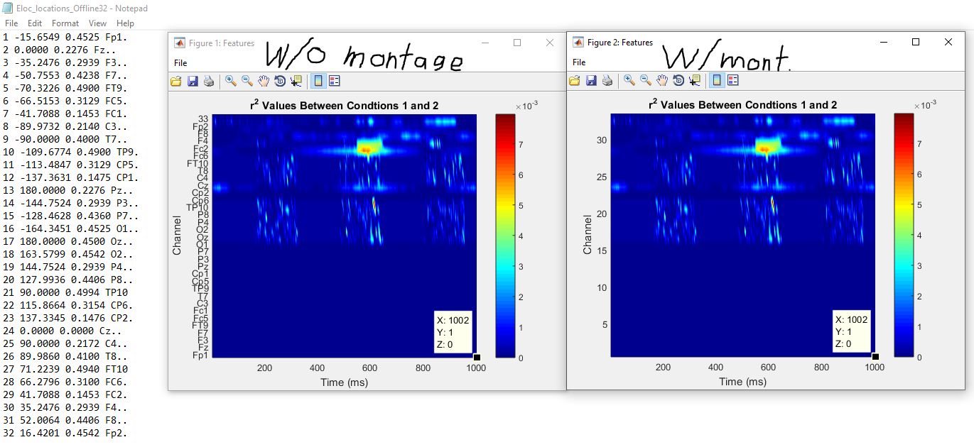

Post by lmiller » 16 Jul 2020, 14:44
Hi Jurgen,
We got the photodiode circle working! Thank you for your help with that. We are now trying to get rid of the photodiode channel (33) when we create the calibration plots using the offline analysis tool, as the data in the photochannel seems to be adding noise to the R2 plot. We created a montage eloc file and loaded it into the BCI offline analysis tool (see images below) but it not removing the photo channel on the R2 plot. Do you know why?
All the best,
Lucas and Kevin

Post by mellinger » 17 Jul 2020, 09:03
sorry I was telling you that channels not listed in the eloc file would be suppressed in the r^2 plot. This is only true for the r^2 topography, not for the channel-vs-offset plot.
I don't think the presence of channel 33 has an adverse effect on that plot, unless you are using CAR.
In general, I think there is something wrong with your amplifier. Channels 1-16 seem to have no signal at all (did you check all channels in the signal display after pressing Set Config?). Channels 17-32 show a strange pattern that reminds of a technical artifact rather than an EEG response.
Could it be that one of the headbox cables is not plugged in properly?

Post by lmiller » 17 Jul 2020, 14:42
Sorry, but we forgot to include that this data was just junk data we collected to see how the montage file interacted with a data set that had the photodiode. There was not an actual subject wearing the cap. The main thing that we wanted to show was the labels and how the montage file affected the output. We did not look at the topo plots after adding the montage file, which was our mistake. Next time we make it into the lab, we should be able to record some meaningful data and we will come back with those results.
