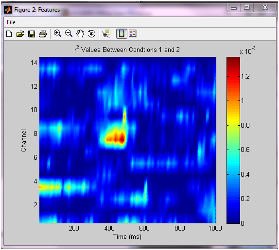

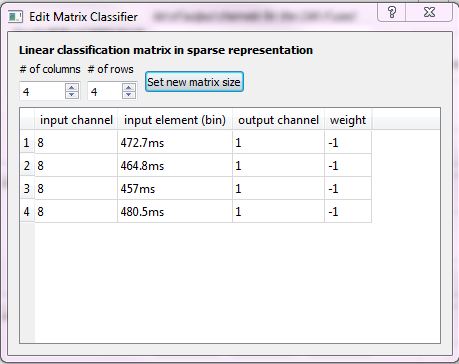

The calibration session went smoothly until when I created a subject-specific parameter file. After I set the matrix for Classifier using 4 values obtained from the previous offline analysis plot, I got this error when I tried to start the experiment again:
LinearClassifier::Preflight: Channel specification in
Classifier(1,input channel)=8
exceeds number of input channels.
Warning: LinearClassifier::Preflight: Specification in physical units:
Classifier(1,input element (bin))=472.7ms
does not exactly meet a single element.
I thought the number of input channels is 14, so I don't know why 8 would exceed number of input channels.

the error message refers to the number of input channels to the LinearClassifier filter, not the number of recorded channels.
The number of channels actually transmitted to the LinearClassifier depends on the TransmitChList parameter. You should list all recorded channels there, from 1 to 14 to have them available for classification.
