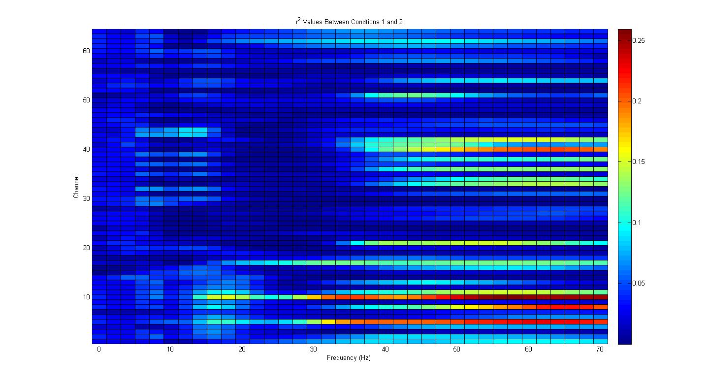

One more question is, after I run the offline analysis tool, I got result on high-frequency, as is shown in the figure. the figure is Left hand condition VS resting condition, based on 60 trials of each condition.
Condition 1: Imagine Left hand
Condition 2: Rest
sampling rate:1000 Hz
filter: 0.1-60 Hz.
What's the possible reason for that?

you can use the EEGLAB functions readloc and writeloc to convert from and to .loc files in various formats.
Regarding the high-frequency correlations in your data, there has gamma band modulation been observed in ECoG data (J Neurosci. 2007 Feb 28;27(9):2424-32.
Spectral changes in cortical surface potentials during motor movement.
Miller KJ, Leuthardt EC, Schalk G, Rao RP, Anderson NR, Moran DW, Miller JW, Ojemann JG.). Maybe your amplifier's SNR is good enough to let some of that through to EEG as well.
