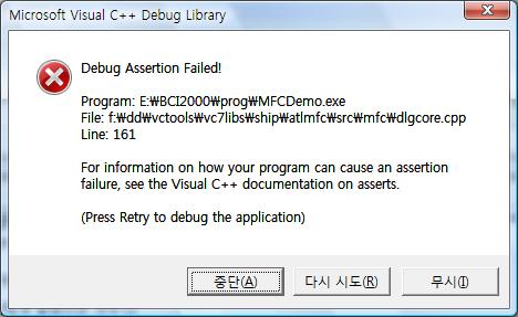

I have a problem when I am running the MFCDemo application module.
I download the source code and build the BCI2000 as the instruction from 'www.bci2000.org/wiki'.
But, when I launch the BCI2000 as below;
Data Acquisition : signalgenertor
Signal Processing : MatlabSignalProcessing
Application : MFCDemo
,I get a error message.
I capture the error message as image file and attached.
How can I solve this problem?
Best Regards,
Hohyun Cho
Re: MFCDemo Errors
Post by mellinger » 09 May 2011, 09:36
Thank you for reporting this problem. I fixed it by adding a missing resource file to the MFCDemo project. Please upgrade your source code to the latest SVN version, and recompile.
