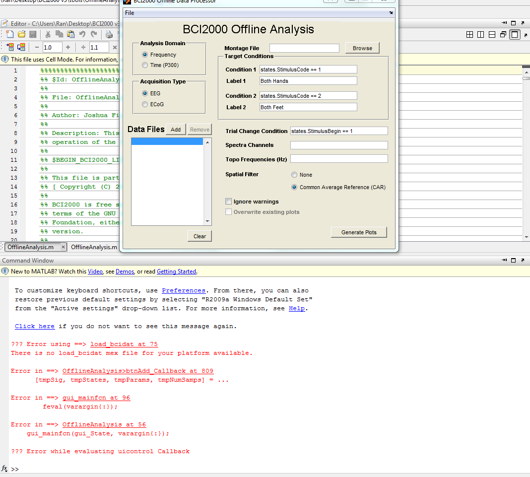

But when I run the M-file in Matlab (2009b), it keeps giving errors (some functions cannot be found) when I am adding data files, even though I already added the mex file into the path.
I am wondering if this tool supports 64-bit system, or there is something I did wrong.

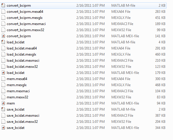

Sorry for the late update. Yes, I found the file in mex folder. However, still no luck.
here is a list of files inside the mex folder:

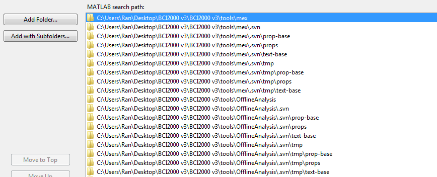

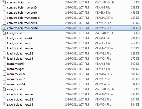

I checked again, and I do have the .mexw64 file (the extension file type was hide), referring to Fig 1.
This morning, I tried BCI2000 on another computer with x64 win 7 system, still no luck.
I list my procedure here, hope we can pinpoint the problem.
1, set path, add mex folder and offline analysis folder (I tried both with and without adding this folder), Fig 2.
2. Run the offlineanalysis.m file or offlineanalysis.fig, everytime it runs, but failed to add files, gives the error like before. It seems there are a lot of functions cannot be recognized.

Re: offline analysis tool on Win 7 64-bit
Hi Ran,
when you run OfflineAnalysis, Matlab finds the load_bcidat.m file in the OfflineAnalysis directory before searching on the path. You will need to either remove the load_bcidat.* files from the OfflineAnalysis directory, or copy the load_bcidat.mexw64 file from BCI2000/tools/mex to the OfflineAnalysis directory.

When I copied the load_bcidat.mexw64 file from BCI2000/tools/mex to the OfflineAnalysis directory, it can add data, but gave error something like "MEM" function cannot be found when generating plots.
When I removed the load_bcidat.* files from the OfflineAnalysis directory, and added the mex to path, it works!
Thank you so much!
