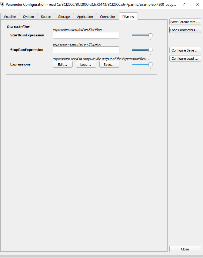

The p3temporalFilter parameters which have EpochsToAverage do not show up for LSLsource configuration attaching a screenshot for your reference. However, it does show up for signal generator . Also the problem is there when we run LSL source with EMOTIV eeg. The task runs fine with signal generator.
Screenshot (17).png (21.58 KiB) Viewed 36877 times
Re: P300 Speller Task not working
Post by mellinger » 20 Apr 2022, 10:18
Hi, can you post the content of the batch file you are using?
