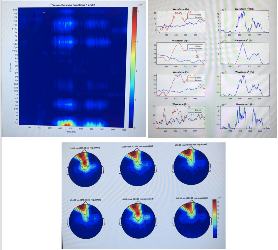

Hi everyone

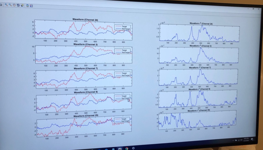

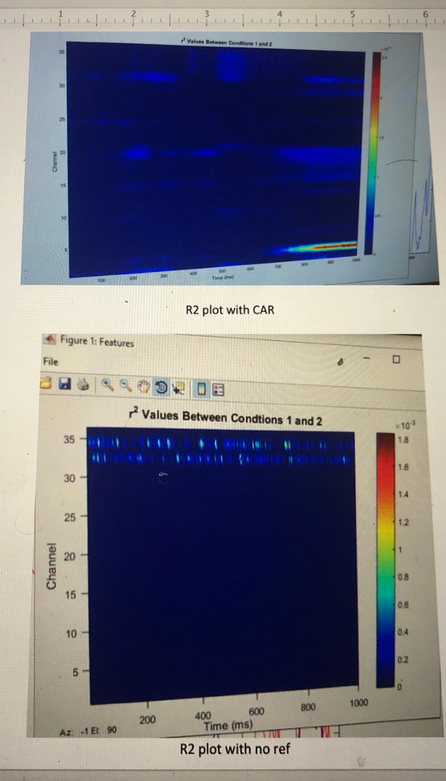

Sorry to post again. I was wondering if I could get some feedback on the r2 plots we got following calibration. I attached some of the config details below, but can provide more if helpful. I was wondering,
1) Do you know why on the no ref R2 plot from the BCI2000 offline analysis tool we don't really have any values except for the very high channels, that seem to extend beyond our sourcech value of 33? The R2 plot can be seen here for the CAR and non ref for the offline analysis tool -
R2 plots.jpg (255.83 KiB) Viewed 40930 times
I attached plots of 2 = Fz, 24 = CZ, 7=FC1, 8=C3, 25=C4 for the no ref setting in the analysis tool, so it seems we have data.
2) Do you think the R2 values for the CAR plot appear acceptable?
I also attached an image our loc file if helpful, as I have not labelled the BCI2K config file per the 10-20 yet, but just left channel values. -

Re: R2 plots following calibration
Post by mellinger » 08 Jun 2020, 11:07
HI,
it's difficult to tell what's going on. Actually, the individual curve plots look quite reasonable, but if your channel topography is correct, they can't be. A P300 response would not appear at Fz/F3/F7 and nowhere else. Also, you shouldn't use the additional channels (likely trigger channels) in the r^2 analysis. What source module are you using?

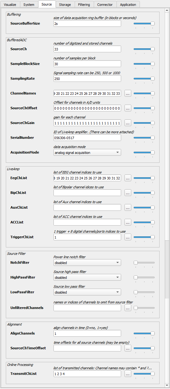

Thanks for the response! I was a little confused on why you are only noting activity on Fz/F3/F7? I did not see an option on the BCI2k offline analysis tool to exclude any non EEG channels from the R2 plot, so I was thinking that was done automatically and that this just included the 32 EEG chans. We are also planning on recording from an Aux channel (photo diode), and the three accelerometer channels, but have not included those yet.
We are using the brain vision liveamp. I attached a screenshot of our source module, though we are using a block of 16, and using a 60Hz notch filter.
3.Source PNG.PNG (61.87 KiB) Viewed 40914 times
We are going to go into the lab to try out things again tomorrow (Tuesday)
I really appreciate your input on this! Please let me know if I can provide you with any more information.
Post by mellinger » 09 Jun 2020, 08:33
I read this from your first r^2 plot. It shows a response in channels 2, 3, and 4. From the photograph of your electrode montage, I read that these channels correspond to Fz, F3, F7.
If you specify a montage file, only channels that appear there are included in the analysis.
I see you have set ChannelNames to 1..33. The meaning of this parameter is to enter channel names, such as Fz, F3, F7 in the order in which they correspond to channels. Naming channels by their numbers is the default, you don’t need to enter anything into ChannelNames if you want this.
TransmitChList is set to 1 2 3 4, this is fine for the calibration session, but you will need to change this for the actual spelling session. You may enter a range such as 1:32 to specify a range of channels.

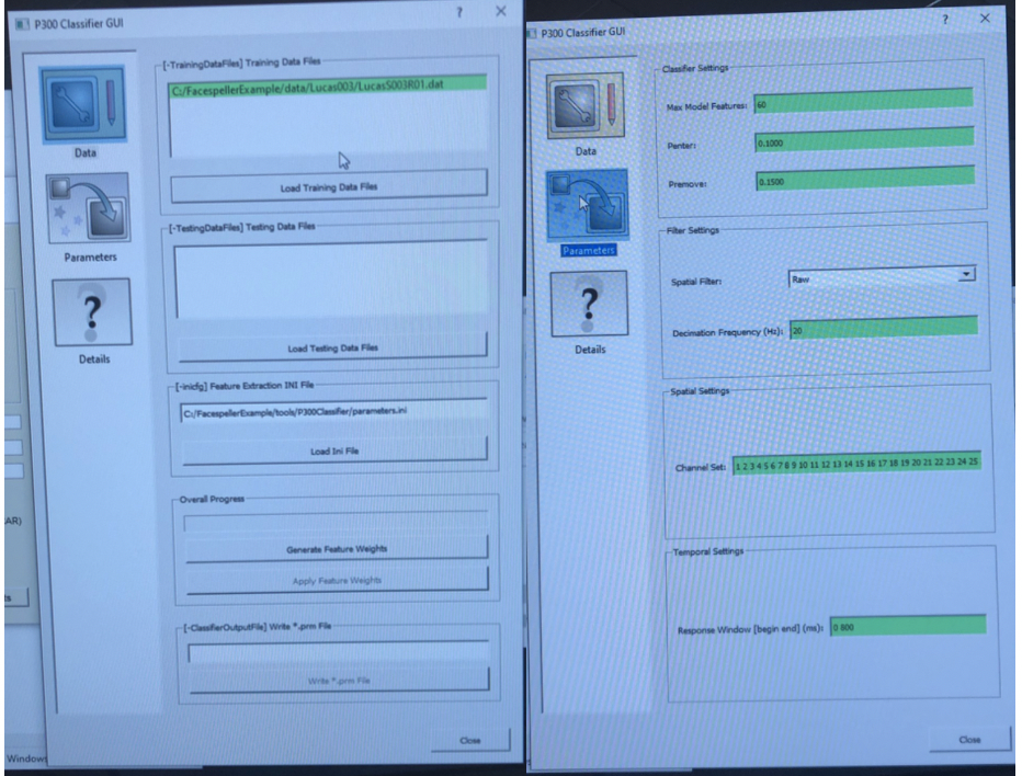

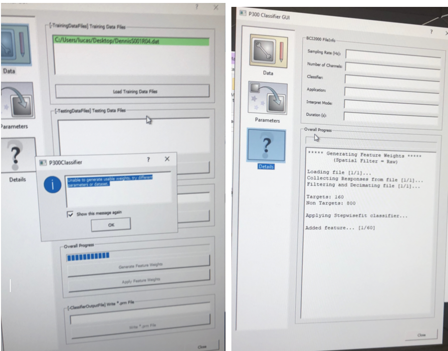

Thank you, that was helpful, though we now hit a new barrier. We edited the source file as your recommended (using 10-20 names, setting the transmitchan list to 1:32), and stopped recording from the trigger (sourcech = the 32 EEGlocs), and that seems to have made our plots a bit better. As the waveform plots look good, similar to last time (this is the same participant), I think the fp1 activity is more likely eye related artifact associated with target presentation, unless you have other thoughts? We will see if it persists with a different participant.
Our new problem arouse when we tried to upload our data to get weights for the classifier for online use. Do you have any guidance on how we should go about trouble shooting this error? We weren't sure whether it had anything to do with our parameters for the linear classifier, which are currently just left as default with 2 rows (below; we are using a full matrix).
Linear classifier.png (10.35 KiB) Viewed 40895 times
Sorry to bother you again, I really appreciate you time and support with this!
I don’t think that you will typically see eye or blink artifacts on one eye but not the other, unless the participant suffers from an asymmetric condition. For a P300 response, the topography is quite irregular. Could you double check whether the associations between channels and electrode locations is correct, e.g. by using a multimeter to test for connection between electrode Cz and plug nr. 24 on the amplifier side? Testing just a few electrodes like this will quickly show errors if something is wrong with your montage information.

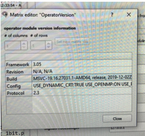

Please make sure to use the latest version of BCI2000 and the P300Classifier program (https://www.bci2000.org/mediawiki/index ... on_History).
We weren't sure whether it had anything to do with our parameters for the linear classifier, which are currently just left as default with 2 rows (we are using a full matrix).
The linear classifier configuration is not used in the calibration session, so it does not matter.

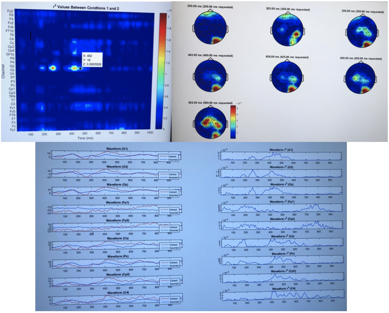

Regarding the classifier, we are using BCI2000 version 3.05, which from what we can see was the most recent stable version. If there another version of the P300 classifier we should be using? We got some more data in the lab last week, and calibrated on 20 letters, with 20 for number of sequences and epochs to average. However, unfortunately we still got the same error as last time that the classifier was unable to generate usable weights. I attached some images below, do you have any thoughts on how we can fix this?
We have been looking at the locations and not found any errors yet. We got data on a different participant last week (below), and things looked a bit better topography wise, though we still have some laterality it the neck area. We will do some more processing on the data. Just to clarify, we are using the face speller (semi transparent faces) with a right ear lobe reference. We are planning to add the other ear lobe reference in during later, during offline/post session processing/analysis.
I hope your weekend is going well.
Plots copy.jpg (284.8 KiB) Viewed 40847 times
Post by mellinger » 15 Jun 2020, 11:03
HI,
your r^2 topographies look really weird, but then r^2 values are very small as well, so the topographies could be just random artifacts, resulting from a slight correlation of muscular artifacts at forehead or neck with the target stimulus.
It might be a good idea to try the standard P300 speller before switching to the variant with semitransparent images, just to make sure that your EEG apparatus and software both work as they should.
