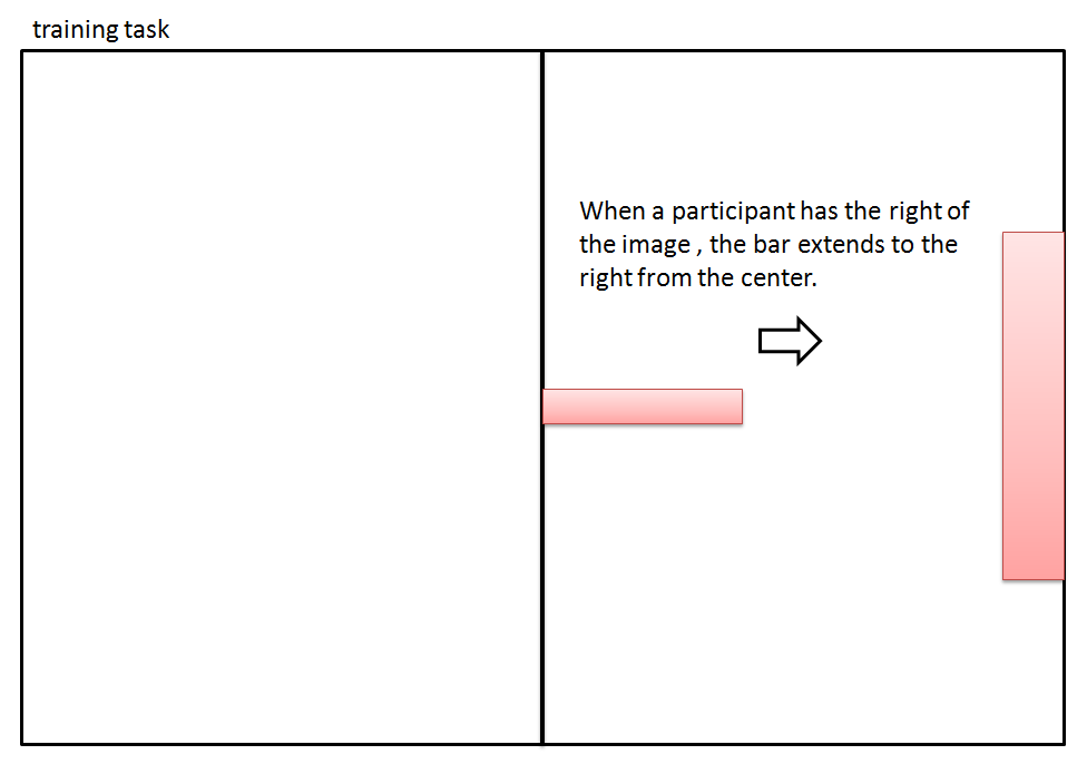

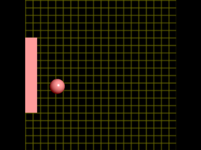

I am studying the BMI at the university.
So I would like to use the BCI2000.

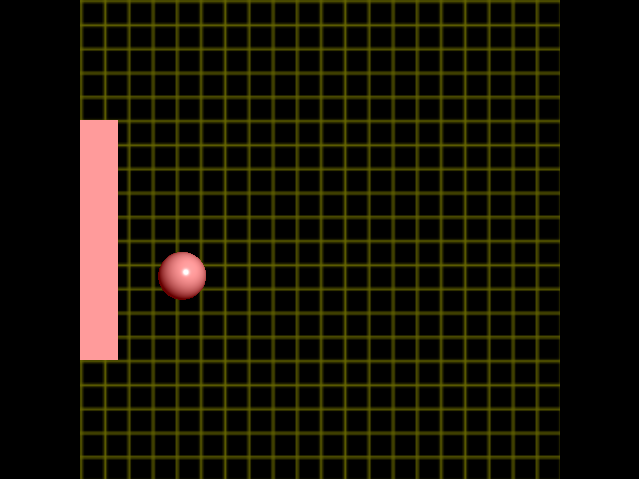

I am looking for source code of CursorTask , such as the following.
Please tell me if you have source code of CursorTask or you know web site of CursorTask source code.
After that, I want to create a training tasks by changing the ball to the bar,such as the locus of the bar can be drawn. I want you to tell me I might be changed anywhere in the program.
regards,
tinui.
regards,
tinui.

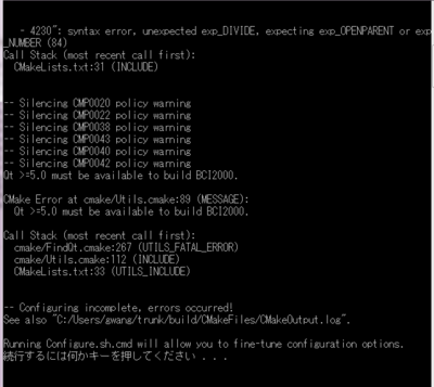

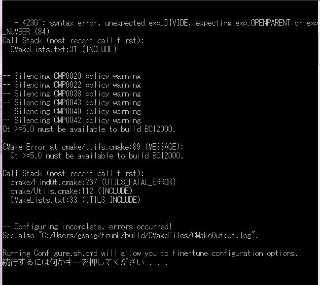

After that, I run the process.
However, when I executed ' "Make VS2012 Project Files.cmd" in the batch folder ', the following error(Fig1.png) came out.
And, I executed ' To fine-tune (e.g., for debugging, disable the application bundling by unchecking USE_APPLICATION_BUNDES) open the "Configure.sh.cmd" to start the CMake GUI, check/uncheck the appropriate options and click at "Configure" and then "Generate" at the bottom left corner of this window" '.
However,I tried to various run, but I get an error. I can't click "Configure" and "Generate".
I looked web site, but I did not know whether I do what solved.
Could you tell me the solution?

tinui
Thank you for replying to my e-mail.
I completed your "Pre-requisites".
Pre-requisites:
* Windows 32 or 64 bit OS. ->32bit
* TortoiseSVN (https://tortoisesvn.net/downloads.html) [make sure to check "command line tools" on installation]->completed
* CMake (https://cmake.org/files/v3.5/cmake-3.5.2-win32-x86.msi) [make sure to check "add to path for all users" on installation]->completed
* Visual Studio 2012 Express (http://www.microsoft.com/en-us/download ... >completed
* Visual Studio 2012 Update 4 (https://www.microsoft.com/en-us/downloa ... >completed
Error's Content

Configuring project BCI2000 Version 3.05
Skipping custom extension DataGloveLogger
---- (to enable, set EXTENSIONS_DATAGLOVELOGGER to ON)
Skipping custom extension WebcamLogger
---- (to enable, set EXTENSIONS_WEBCAMLOGGER to ON)
Skipping custom extension EyetrackerLogger
---- (to enable, set EXTENSIONS_EYETRACKERLOGGER to ON)
Skipping custom extension WiimoteLogger
---- (to enable, set EXTENSIONS_WIIMOTELOGGER to ON)
Skipping custom extension GazeMonitorFilter
---- (to enable, set EXTENSIONS_GAZEMONITORFILTER to ON)
Skipping custom extension AudioExtension
---- (to enable, set EXTENSIONS_AUDIOEXTENSION to ON)
Skipping custom extension StimBoxFilter
---- (to enable, set EXTENSIONS_STIMBOXFILTER to ON)
Skipping custom extension CyberGloveLogger
---- (to enable, set EXTENSIONS_CYBERGLOVELOGGER to ON)
Skipping custom extension EyetrackerLoggerTobii3
---- (to enable, set EXTENSIONS_EYETRACKERLOGGERTOBII3 to ON)
Skipping custom extension EyetrackerLoggerTobiiX
---- (to enable, set EXTENSIONS_EYETRACKERLOGGERTOBIIX to ON)
Skipping custom extension ParallelPortFilter
---- (to enable, set EXTENSIONS_PARALLELPORTFILTER to ON)
Target #1: LibTiny_StaticCrt (Tiny utility library, STATIC_LIBRARY)
Target #2: LibTiny_DynamicCrt (Tiny utility library, STATIC_LIBRARY)
Target #3: BCI2000FrameworkCore_StaticCrt (Framework library, STATIC_LIBRARY)
Target #4: BCI2000FrameworkCore_DynamicCrt (Framework library, STATIC_LIBRARY)
Target #5: BCI2000FrameworkSigSrcModule (Framework library, STATIC_LIBRARY)
Target #6: BCI2000FrameworkSigProcModule (Framework library, STATIC_LIBRARY)
Target #7: BCI2000FrameworkAppModule (Framework library, STATIC_LIBRARY)
Target #8: NewBCI2000Module (Custom bootstrapping tool, CONSOLEAPP)
Target #9: NewBCI2000Filter (Custom bootstrapping tool, CONSOLEAPP)
Target #10: DylibTool (CONSOLEAPP)
CMake Error at CMakeFiles/extlib/qt-5.3.2/win32-msvc2012/lib/cmake/Qt5Core/Qt5CoreMacros.cmake:109 (set):
Syntax error in cmake code at
C:/Users/gwang/trunk/build/CMakeFiles/extlib/qt-5.3.2/win32-msvc2012/lib/cmake/Qt5Core/Qt5CoreMacros.cmake:109
when parsing string
-IC:/Users/gwang/trunk/src/shared/compat;-IC:/Users/gwang/trunk/src/shared/compat/C99Inttypes;-IC:/Users/gwang/trunk/src/shared/utils/Lib;-IC:/Users/gwang/trunk/build/CMakeFiles/buildutils/SchedulingTool;-IC:/Users/gwang/trunk/build/buildutils/SchedulingTool;-IC:/Users/gwang/trunk/build/CMakeFiles/buildutils/SchedulingTool;-DPROJECT_REVISION="�p�X: C:\Users\gwang\trunk
Working Copy Root Path: C:\Users\gwang\trunk
URL: https://www.bci2000.org/svn/trunk
Relative URL: ^/trunk
���|�W�g���̃��[�g: https://www.bci2000.org/svn
���|�W�g�� UUID: 7ef59cdf-0624-0410-a474-e34ce222aafa
���r�W����: 5367
�m�[�h����: �f�B���N�g��
�������̏���: ���ɂȂ�
�ŏI�ύX��: mellinger
�ŏI�ύX���r�W����: 5367
�ŏI�ύX����: 2016-05-20 04:34:26 +0900 (2016/05/20 (��))
";PROJECT_DATE="�p�X: C:\Users\gwang\trunk
���r�W����: 5367
�������̏���: ���ɂȂ�
�ŏI�ύX��: mellinger
(��))";PROJECT_NAME="BCI2000";PROJECT_TIMESPAN="2000-2016";PROJECT_DOMAIN="bci2000.org";PROJECT_VERSION="3.05";WEBSEARCH_DOMAIN="www.google.com";BUILD_USER="gwang@";DISABLE_UNITTEST;DISABLE_BCITEST=1;_USE_MATH_DEFINES;NOMINMAX;_CRT_SECURE_NO_WARNINGS;_CRT_SECURE_NO_DEPRECATE;_CRT_NONSTDC_NO_WARNINGS;_SCL_SECURE_NO_WARNINGS;COMPILER_NAME="MSVC-17.0.61030.0-x86";DISABLE_BCITEST;HAVE_LIB_TINY;USE_QT;-DWIN32
Invalid escape sequence \U
Call Stack (most recent call first):
CMakeFiles/extlib/qt-5.3.2/win32-msvc2012/lib/cmake/Qt5Core/Qt5CoreMacros.cmake:181 (qt5_create_moc_command)
cmake/FindQt.cmake:158 (QT5_WRAP_CPP)
cmake/Utils.cmake:207 (QT_WRAP_CPP)
cmake/AddTargetMacro.cmake:95 (UTILS_AUTOMOC)
buildutils/SchedulingTool/CMakeLists.txt:9 (BCI2000_ADD_TARGET)
Configuring incomplete, errors occurred!
See also "C:/Users/gwang/trunk/build/CMakeFiles/CMakeOutput.log".

this is odd. Can you please check if you have at least Update 4 installed for Visual Studio 2012. You can see that in the Help / About Visual Studio menu that shows the about box with the version and update number.
Let me know.
Let me know.
- Posts: 344
- Joined: 17 Sep 2010, 12:43
Re: looking for source code of CursorTask
Tinui,
I just realized that you are using a non-western Windows. It could be that CMake has issues processing the characters in your data and path format. You can try to change the localization on your Windows to US english, including the date format. Also please check that are not having any special non-western characters in your file paths for BCI2000.
If this does not work, try to use a western Windows, or install a virtual machine with a western Windows for compiling. The compiled version should then run fine on your non-western system.
- Posts: 344
Tinui,
please also try to set the the LANG environment variable to en_US. If this does not work, uninstall TortoiseSVN and then re-install it without the command line tools.
Delete the build folder and update to SVN 5368. This should hopefully then do the trick.

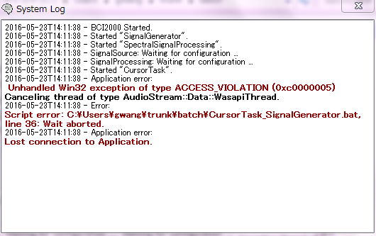

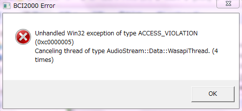

After that, I tried to run the batch file of CursorTask_SignalGenerator.
However, new errors have occurred.(BCI2000.PNG & System Log.PNG)
tinui
I was able to resolve the error to thank for your reply.
And,when I did the build of "BCI2000.sln" and did debug, I was able to run well.
So,I completed process.

are you running any audio output in the background, e.g., audio streaming?
What version and bit-ness (32/64) of Windows are you using?
What sound card are you using? can you post a screen shot from your device manager?
To further isolate the issue, can you please try to install and run the latest beta to see if the issue persists?
http://bci2000.org/downloads/bin/BCI200 ... p.exe.html
If the issue persists, can you try to make the following modification to the task:
Let me know if any of this resolves the issue.
src/shared/utils/AV/AudioDevice.cpp
line 62
#define WASAPI_VIA_PA 1

- Posts: 16
- Joined: 14 May 2015, 02:11
Hi,Peter.
I am sorry to you to just question.
The main issue is, I think trying to make the training task, such as the following(training task.png).
By changing the ball to the bar, we want to make the training task that the trajectory of the bar is drawn.
When a participant has the right of the image , the bar extends to the right from the center.
If a participant has the left of the image,the bar extends to the left from the center.
Is it possible to create a training tasks by changing the source code of CursorFeedbackTask.cpp?
tinui
tinui
- Posts: 344
Tinui,
you have three options:
1) Modify the CursorTask, however this task does a lot more than you need (e.g., 3D scenes)
2) Modify the FeedbackDemoTask, which should be easy as this is a simple 2D task. \
3) Generate your own task using the NewBCI2000Module.exe tool and selecting a new application in the Menu. BCI2000 has some classes that you should use for your graphic objects, such as RectangularShape
In the header file of your new application just define a rectangular shape object and a rect object for the position. Set the position and the initialize your rectangular shape object. You can see an example of that in the FeedbackScene2D.cpp and h file.
RectangularShape *mp_shaded_region;
GUI::Rect m_gauge_target_rectangle;
mp_shaded_region = new RectangularShape(mrDisplay);
mp_shaded_region->SetDisplayRect(m_gauge_target_rectangle);
mp_shaded_region->SetScalingMode(1);
mp_shaded_region->SetColor(RGBColor::White);
mp_shaded_region->SetFillColor(RGBColor(0x90EE90));
tinui
