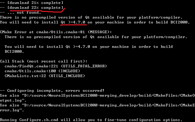

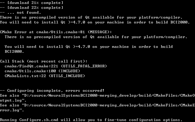

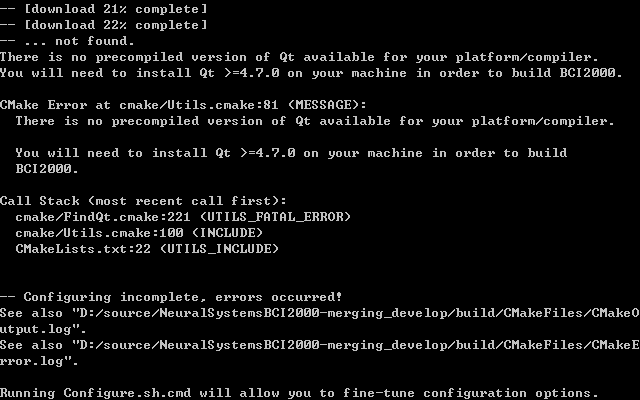

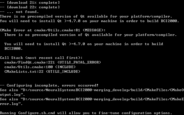

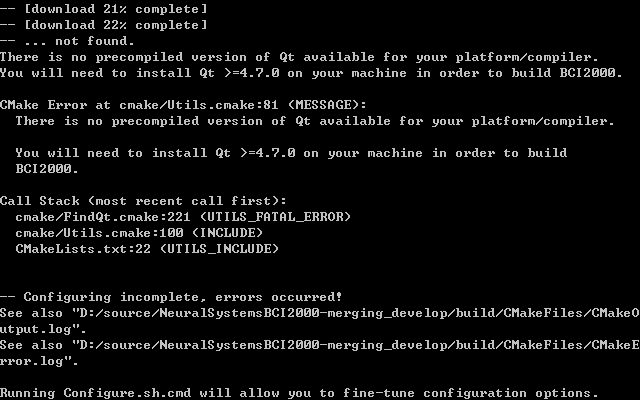

I down another revision from github and run the Make VS10 Project Files.cmd, but there is still some mistakes
[img]file:///C:/Users/sss/Desktop/1852_1.png[/img]
i want to know what's wrong?And how can i solve it?
Thank you very much!

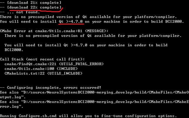

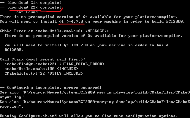

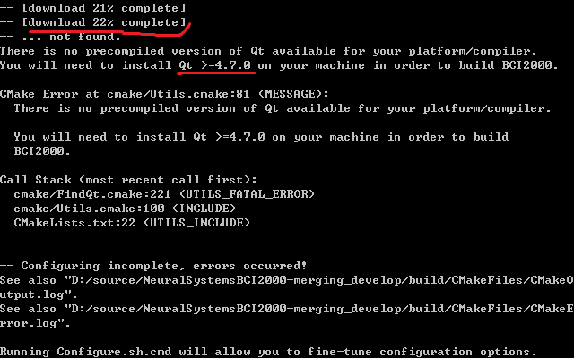

Thank you,i will try.And also i think there is something with qt,as the picture shows.It downloading the Qt all the time,but i already has installed it,i don't know why.The versions problem?
- Posts: 344
- Joined: 17 Sep 2010, 12:43
Re: Compile with cmake
In the standard configuration, BCI2000 downloads a pre-compiled statically linked version of Qt. If you have a very slow internet connection, this might time out. You can increase the timeout in /build/cmake/Utils.cmake file by increasing the numbers that follow the TIMEOUT variable.
Please note that there are two versions of BCI2000.
1) The last release v3.0.5. which is now two years old: http://www.bci2000.org/svn/tags/releases/current
2) The upcoming release v3.6: http://www.bci2000.org/svn/trunk
The trunk version needs Qt5.3 while the older v3.0.5 version needs Qt4.7.0. For the trunk version you can also use your own pre-installed Qt5.3 or newer version by executing the Configure.sh.cmd script and toggling the USE_EXTERNAL_QT switch.
As we are shortly releasing v3.6, I recommend that you use the trunk version for your developments:
For that reason, please check that you have download the trunk version from: http://www.bci2000.org/svn/trunk
