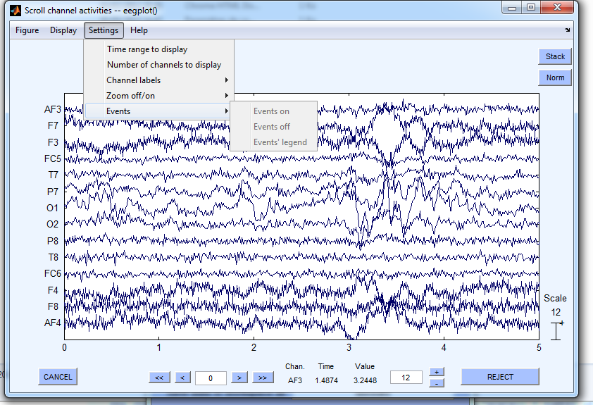

then i define the state as FTStateFromBuffer
and then i try to set event to the state in matlab:
if(tot_Power<0.5)
event.type = 'Running';
event.value = 1;
event.offset = 0;
event.duration = 0;
ft_write_event(filename, event);
end
but the state is always 0. there is no change of the value of the state and i have no event in the filename.

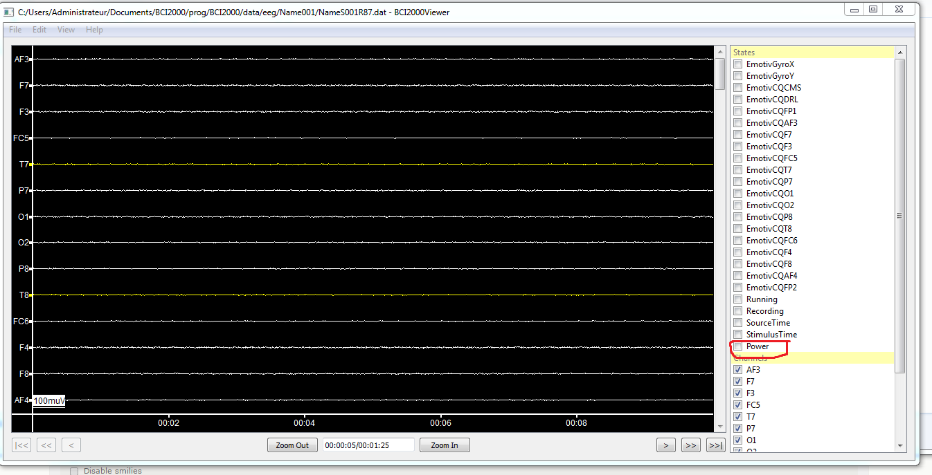

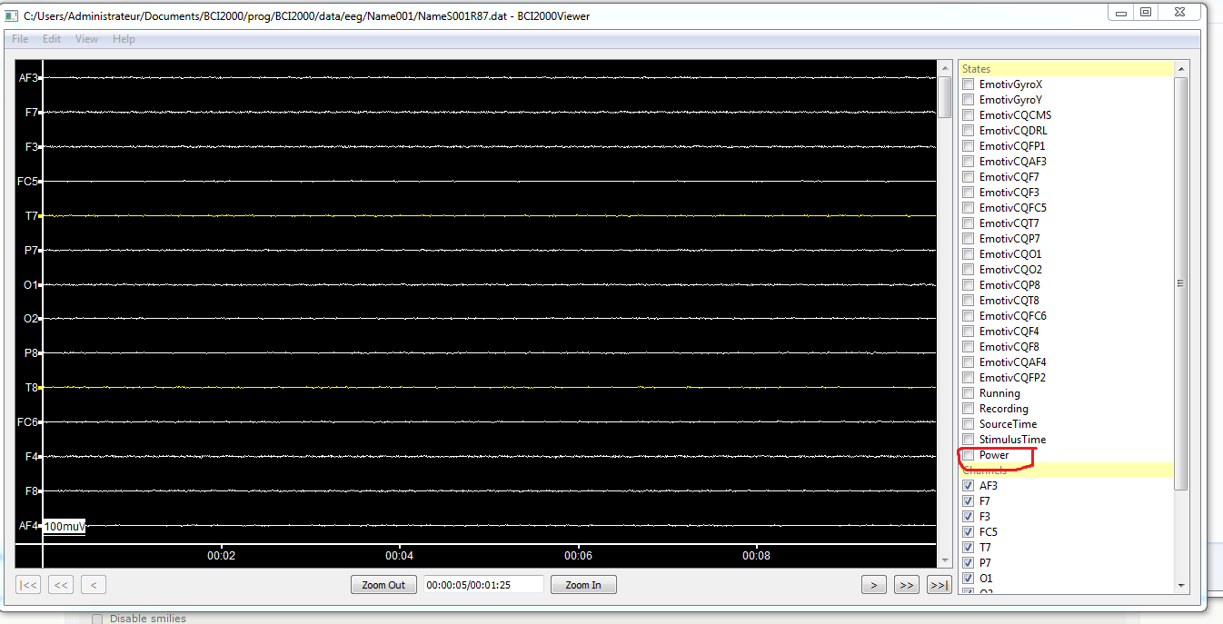

It seems like you created a BCI2000 parameter rather than a state. It shows up in the parameter display!
You need to create a new state, which can be done either through the C++ interface within a filter within a module, or using BCI2000 Operator scripting:
http://www.bci2000.org/wiki/index.php/U ... _Scripting
You can verify that the state exists by either loading the data file into Matlab using load_bcidat or by recording a little data file, and inspecting it using BCI2000Viewer. Once you have verified that the state does indeed exist, you can write to it using FIeldtrip/Matlab.

Hi
thans u for your ansewer ! I used BCI2000 Operator scripting and i created a new state "Power",
and i defined an event to this new state but i don't have an event in my filename!
