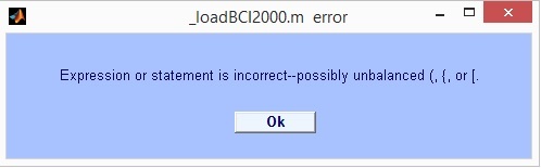

I am trying to import bci2000 .dat files into matlab using eeglab v11.0.4.3b. On importing data using "Import BCI .dat files" i get a _loadBCI2000.m error that reads "Expression or statement is incorrect-possibly unbalanced (,{ or [."
Has anyone faced this problem and what have you done about it?

If you can use a new version of EEGLAB (v13.x) then please do that. The new version of EEGLAB has a menu to download plugins, including a newer version of the BCI2000 data import plugin that I modified last year.
Let me know if you are on a Mac. The Mac binaries are 2 years older than the windows binaries, and this creates a problem in my code. I'd like to create new binaries, but this is a slow process. If you need the plugin fixed for Macs now then I will do that quick patch first.

No i am on windows 8.
i used the latest version of eeglab(v 13.x) and further downloaded the latest version of BCI2000-IMPORT plugin(v 0.34).
But the same problem persists on attempting to import the .dat file option.

I've attached a (slightly) updated version of pop_loadBCI2000.m . However, this does not differ from the version downloaded with the plugin in a way that would fix the error you see. I can only guess that either you are not using the correct version of the plugin (perhaps the old eeglab is still on the path? Please check that) or there is something specific to your system, though I can't imagine what.

no i checked the path and i am using the latest version of the plugins.
On running the pop_loadBCI2000.m file it says error on line 99 with an unbalanced bracket.

Ah I think I know what it is. Are you using a version of Matlab older than 2009b? I'll patch the function, upload it here, and also post it to the EEGLAB repository. I'll do that sometime within the next 24 hours. Sorry about that.

See the attached file. I will add it to the BCI2000 svn and the EEGLAB repo soon.
- pop_loadBCI2000.m.zip
- No longer uses null (~) output arguments, to be compatible with pre R2009b.
- (4.02 KiB) Downloaded 1010 times

YES it worked.thank you so much.
