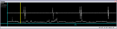

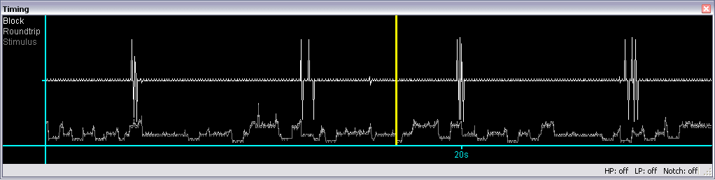

Im sorry if this has been addressed before.

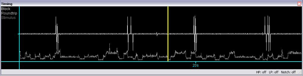

I am having irregular timing when I connect two gUSB amplifiers for recording. I don't have this problem when I record with one.
Timing plot with two amps
I am using the CursorTask_gUSBamp batch file that came with the distribution, and two gUSBamps connected with a sync cable. I tried uploading the parameter file, but this not allowed? I am recording at 256 sps, 16 channels, 8 on each amp.
Could this be a driver issue? My amps are ~6 years old (not exactly sure if they are version 2, or earlier). I tried following the instructions about drivers on the User Reference:gUSBampADC page http_nospam_www.bci2000.org/wiki/index. ... gUSBampADC. I do have gUSBamp.dll (version 1.0.0.1) in my Windows\system32 folder, but no such driver in by BCI2000/prog directory.

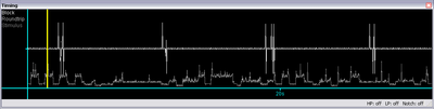

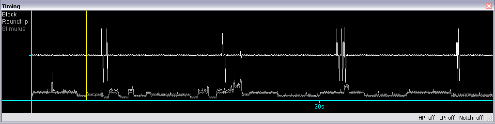

With both amps connected, I get block time irregularities every 5 seconds or so. (This is an improvement compared to nearly continuous block irregularities)
2 amplifiers connected

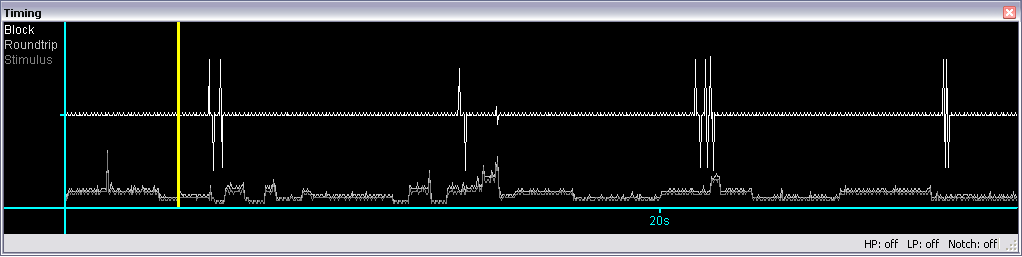

When I ran CursorTask with 1 amp, I saw no timing irregularities

gschalk
Posts: 615
Joined: 28 Jan 2003, 12:37
Re: Irregular timing with 2 g.tec amps
Post by gschalk » 28 May 2013, 14:28
Which BCI2000 version are you using?
Gerv

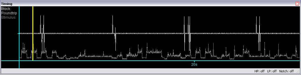

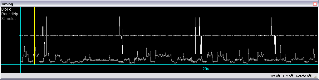

While CursorTask was running, I changed the priority on the gUSBampSource process from Realtime to Normal to Low.
Realtime:
Realtime Priority
Realtime Priority
Normal:
Normal Priority
Normal Priority
Low:
Low Priority
Low Priority
It makes sense that the stimulus duration becomes more erratic when I devote more CPU to the source module, but I see no differences in the block irregularities.
