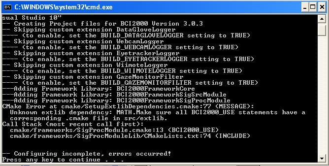

Thanks for the fix. I updated my BCI2000 folder on SVN and tried to make the new Visual Studio solution, but I get an error show in the attached picture.
I might just be doing something silly.
In the meantime I have downloaded the binaries so will try that.

Sorry the previous reply can be ignored.
I updated my cmake folder again and now it works fine.
Thanks!
