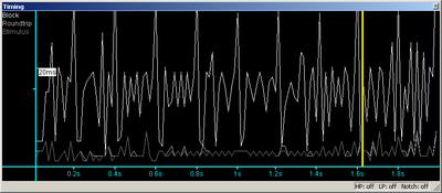

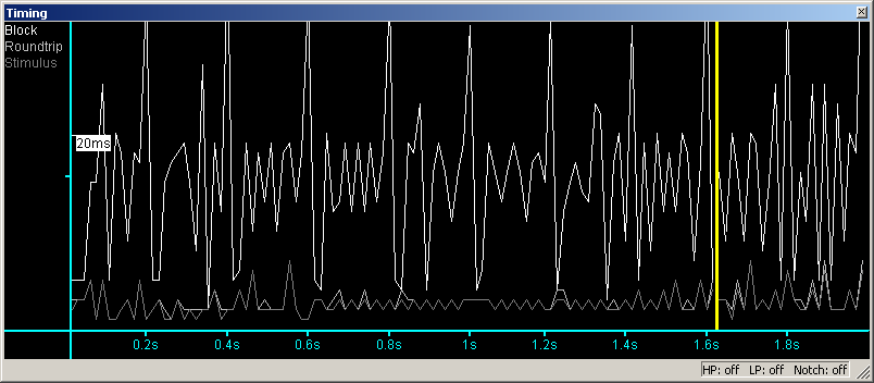

Another problem I've seen is that the Neurosky ThinkGear SDK provides rather poor timing with regards to jitter. The module simply pulls data (sample by sample) from the SDK because it allows for this. The SDK gives no clear indication as to what the internal sample block size is (if there is one) and seems to have very poor timing.
This could be why you were unable to find any sort of P300 response.
-Griff
Poor Timing.
Poor Timing.
