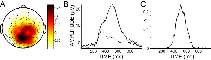

The spatial amplitude distribution of the P300 potential is symmetric around Cz. It is largest at the parietal electrode sites and is attenuated as the recording sites move to central and frontal locations.
Temporally, a typical P300 response has a width of 150-200 ms, and a triangular shape.
The peak potential of a P300 is typically 2-5
, which is less than the brain's background activity. Thus, a single P300's signal-to-noise ratio is low, and is typically enhanced by averaging over multiple responses.
NOTE: In the images B and C above, stimulus presentation did not occur at time offset 200ms rather than 0. The additional offset is due to technical reasons, and always corresponds to the duration of a data block in BCI2000.
