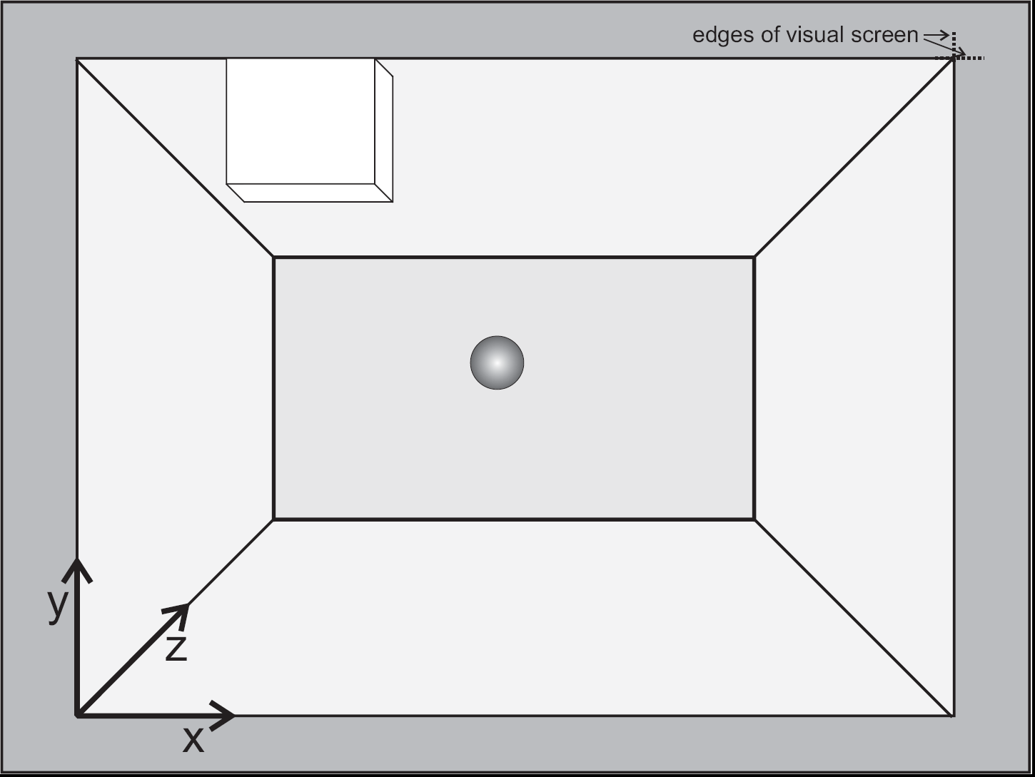

I am trying to implement the 3D cursor task and was wondering what my setup should be to create the five bounded rectangle 3D environment shown below. [CursorTask_Screen.png[/attachment][/img]]

Set the CameraProjection parameter to "wide angle perspective".

Re: 3D Cursor Task Setup
So to move the cursor along the z axis does it simply require setting the rendering quality to high and adding buffer conditions and targets?
- Posts: 1343
Right, z direction corresponds to the third output channel of the normalizer filter. You should create an entry for the third output channel in the LinearClassifier, describing the signal you want to use for z control, e.g. amplitude at 10Hz over the right motor cortex minus amplitude at 10Hz over left motor cortex.
