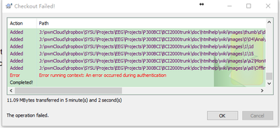

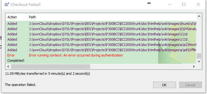

After the username and password are typed, files are added automatically. But after adding several folders and files, a dialog windowing asking for username and password popped up again. I retyped them, click OK. And the following message showed:
An error occurred during authentication. A screen capture of the error message is attached.
The downloaded files can not compiled successfully. Is it because of the failed downloaded files?

After the first error, just right-click the download folder, and choose "SVN update", and repeat until everything has been downloaded.
You cannot compile BCI2000 unless you downloaded all of its source code.
