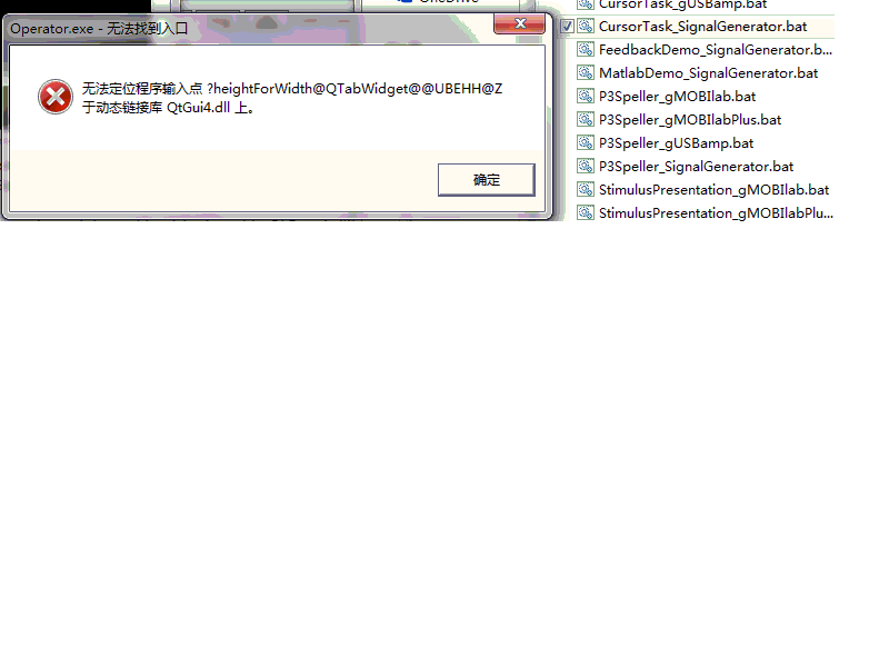

I have donwload source from http://www.bci2000.org/svn/trunk
And change (USE_STD_QT FALSE) to (USE_STD_QT TRUE) in \source\build\cmake
\FindQT.
Then It's can built in VS2010.
I am built all BCI2000.sln in Release.
open the CursorTask_SignalGenerator.bat.
have a error about some entry points could not be found in QtCore4.dll
win7 64bit
VS2010
cmake 2.83
SVN
\FindQT.
win7 64bit
VS2010
cmake 2.83
SVN

Did you try running "Make VS10 Project Files.cmc"?
That launches the Configure.sh.cmd script which, among many things, downloads a static Qt that BCI2000 is developed against. The method you described SHOULD work, but maybe the version of Qt you have on your system is incompatible, or maybe there's a problem with localization settings somewhere.

This problem has been resolved.
I have download qt-opensource-windows-x86-vs2010-4.8.6.exe, and built in VS2010.
Than built BCI2000 in VS2010. It's OK.
