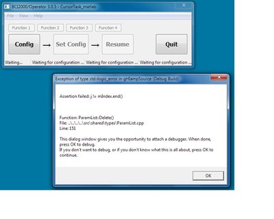

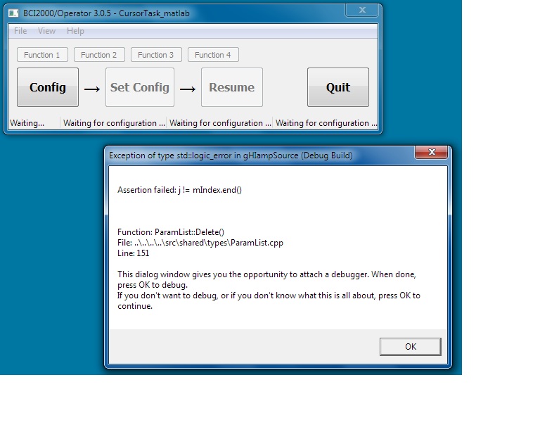

Thanks a lot for your 64bit g.HIamp.exe file. That error solved but a new one appeared when I clicked on the Set Config. I think this is just due to the other exe files that are not suitable for 64 bit system operator. Because I checked the BCI2000 with my laptop (win 32bit) and worked correctly, but on the laboratory’s system (64bit) shows me the error that have attached.
Thanks
Amin

Yikes... That looks like a bug. I'm unable to debug without a Hiamp, this was from HEAD SVN, so we should take a closer look.
For now, I guess you're going to have to go with 32 bit. If that's simply impossible, you could try downloading SVN HEAD and compiling previous versions until the executable works.
Sorry about that, good luck!
-Griff
-Griff
