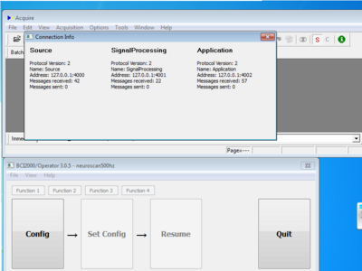

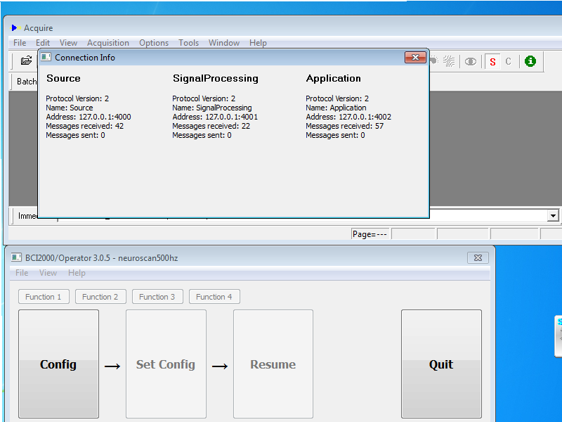

Situation changes when i try to run modified (in the original StimulusPresentation_SignalGenerator.bat NeuroscanClient was used instead of Signalgenerator and new parameter file [obtained by means of the neurogetparams Command Line Tool] instead of "../parms/examples/StimulusPresentation_SignalGenerator.prm") .bat-file.
It looks like the source module can't connect to the neuroscan acquire system (acquire 4.5 to be exact)
When operator module windows appears, its impossible to start application. If i press "set config" nothing happens for some time, then it becomes impossible to even press "set config" button :D (what i get is displayed on the attached file), also no eror messages appears.

Re: *.bat files and neuroscanclient
Post by mellinger » 21 Aug 2012, 11:26
the
parameter file contains the full parameter information for a stimulus experiment. You cannot replace it with a parameter file generated by neurogetparams.
Rather, you need to load both parameter files, first the StimulusPresentation_SignalGenerator.prm, and then the one created by neurogetparams.
