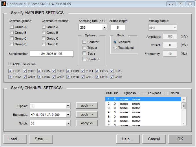

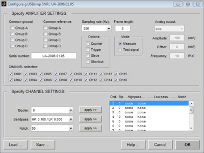

I've attached a clip of the gusbamp GUI in Matlab in case it is useful. Obviously BCI2000's interface is quite different, but it might give you an idea about the features that gtec thinks should be user-facing.
