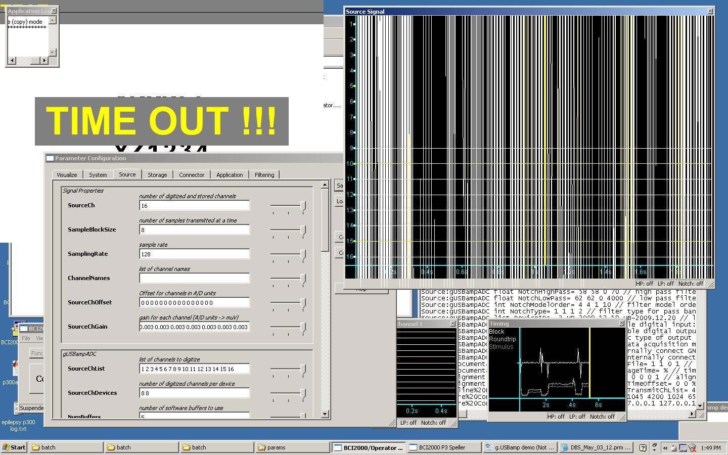

Tried today connecting BCI2000 v 3.0.2 to a gUSBamp amplifier (actually 2 of them) and got the EEG as displayed on the attach. Some of the settings are visible as well.
Anyone familiar with this issue? I guess it has to do with the configuration.

Do you have the same problem on individual amps?
Do you have the same problem using 256 Hz, and/or with the filters/notch turned off?

You need to avoid floating inputs at the amp. Connect both positive and negative inputs of unused channels to ground.

Okay, yesterday we had another session with different parameters, and it worked. Seems to be a configuration-related issue... fortunately.
Thanks!
