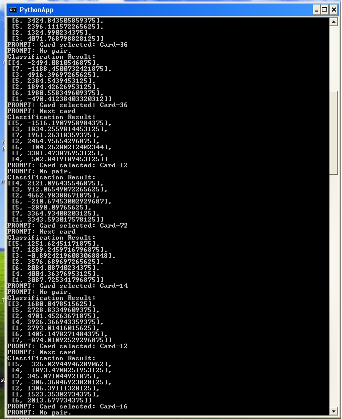

After a few hang ups, we have the program running fine, except that we have 0% accuracy. Even when using a parameter created on a speller matrix of the same size, none of the computer's choices are correct. The classification results reported do not seem right either; according to one of our programmers, the two selections (highest row score and highest column score) should be very different from all of the other scores. All of the scores we are seeing are fairly similar (see attached example output). The program still chooses the highest two values, though. So, it seems that the issue is somewhere between the EEG signals from the brain and the computer's interpretation of them. Spelling on the modified speller (3x4) with that same parameter worked perfectly.

We suspect that the problem may be in the synchronization of the EEG P300 signals with the flashing of the application. As I said, the classification results do not appear to be right, as if the program isn't actually registering the P300 signals that occur with the flashes. Does seem like a plausible explanation?
Since it appears that the accuracy decreased over time, we were thinking that it might be a timing issue that compounds.

Do you have a photosensor that you can hook up as an EEG input? Setup your source and signal processing to only use a single channel then plug the photosensor into that channel. Load the data offline and look at the relative timing of the targetcode state change and the response. I don't have much time to get into this right now but I saw you haven't had a reply yet so I thought I'd give you something to try.
