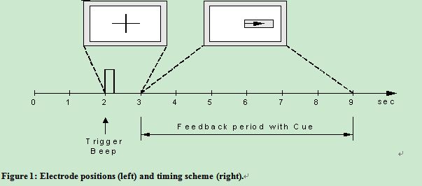

I want to use the competition data to train arithmetic, and now FilePlayback imports these data, but i don't know how to set the parameters of Sequencing in the application.jawilson wrote:This is not something you can really do. Technically, you could use the FilePlayback module, but the CursorTask would have to be configured exactly the same for it to even begin to work, but even then it is probably not going to work as you intend it to. We really don't recommend doing this. BCi2000 is meant to be a real-time, online BCI tool, and is not intended for offline analyses.
The preferred method for learning about controlling the BCI is to use the SignalGenerator module, and configure it to modulate the signal amplitudes with the mouse. See the Wiki for more info on doing this, and let us know if you have further questions.
Adam
the data was from 2003 competition, two classes, we use the training data, 9s for each trial,
