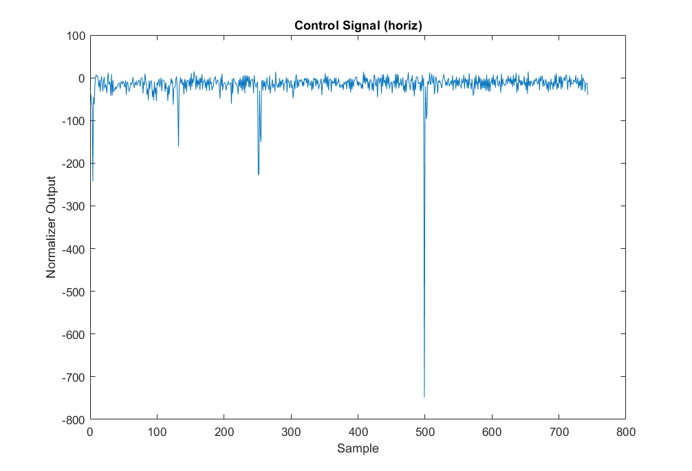

Happy to report that I am receiving Normalizer's output just fine:
I appreciate your help tremendously!
The skew towards nearly exclusively negative values is due to some noise (appears to be slightly <1Hz, not quite sure what it could be) seen on my C3 electrode, which has a weight of -1 in the Linear Classifier. To reduce this, I'm going to try to relocate my setup to a less noisy area. If that does not work, I'm going to reconsider these active electrodes since they were quite bothersome to implement and are not resolving noise issues as effectively as I'd hope. I've a source filter implemented that is bandpassing 1Hz to 40 Hz, notching 60 Hz. I'd welcome any advice in dealing w/ these noise problems!

Also, would you happen to have any further insight/pointers as to what my Normalizer parameters should be, given that I'm looking for continuous update w/ no trials?
Your parameters look reasonable to me. Note that you will need to design the task such that positive and negative deflections of the signal ampliftude will occur with the same probability, otherwise the normalizer will not work properly if you cannot use per-target buffers.
