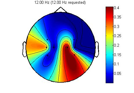

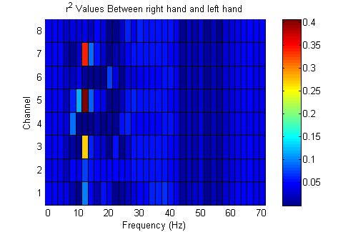

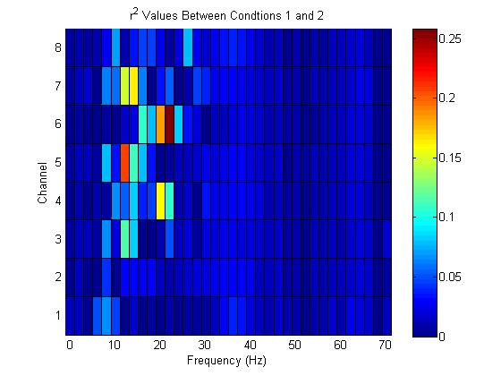

I use offline analysis tool.
Target Condition 1:states.StimulusCode == 1
Target Condition Label 1: left hand
Target Condition 1:states.StimulusCode == 2
Target Condition Label 2: right hand
the results are above figures. channel 5 is Fc3, channel 7 is Fc4.
I think the results are wrong. why only the right part has red color in the topgraphy?
Re: some problems with offline analysis
your results look good. There seems to be a problem with low frequency noise, though. Make sure that all impedances are below 25kOhms.
You are right that right and left hand curves should be reverted between FP3 and FP4. However, you might get some distortion due to asymmetric choice of ground and reference. Use "CAR" as a spatial filtering option in OfflineAnalysis to avoid this.

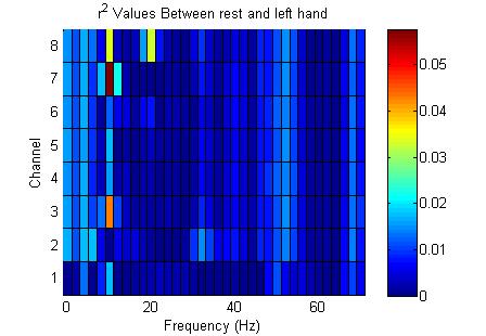

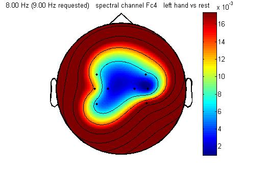

actually, above three figures are 1 run analysis.
I get 7 runs in totally.
the analysis of total 7 runs data as follow 3 figures.
both channel 3(C3) and channel 7(FC4) have high r square value in the two figures. I think it should be different. I don't know the reason. whether the result is correct? what's the indication of this result?
and the left hand &rest topgraphy is ok? I don't know how to explain the topgraphy,why most regions have red color?
Both your amplitude difference and r^2 values are low, so don't try to interpret them too much. The overall red color in the amplitude difference plot is probably an extrapolation artifact.
Try to get your impedances below 25kOhms to improve your results.

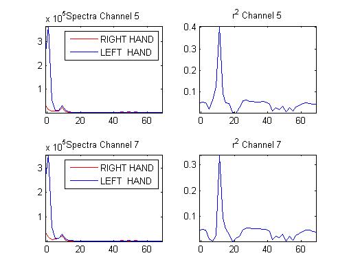

Hi, from the spectra , the spectra value of left hand is very close to right hand, their curves are same. what's the problem with the curve? I think the curve indicates that left hand and right hand cannot be discriminated. Is my view right? why you think the result seems good?
- spectra.jpg (27.5 KiB) Viewed 19512 times
No, there is a visible difference between the curves. It would be better visible if the zero peak in the spectrum were not there, it leads to a rescaling of the plot. From the r^2 plots, one can tell that the difference is significant at 10 Hz.Hi, from the spectra , the spectra value of left hand is very close to right hand, their curves are same.
The r^2 plots show that left and right hand can be discriminated well. 0.4 is a relatively high r^2 value. The only problem is that, as far as one can see from the plots, the curve at FC3 looks much the same as it does at FC4. Typically, you would expect the "left hand" curve and the "right hand" curve to exchange roles when going from the left to the right hemisphere.what's the problem with the curve? I think the curve indicates that left hand and right hand cannot be discriminated. Is my view right? why you think the result seems good?

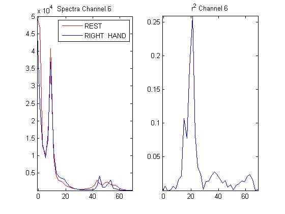

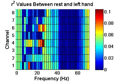

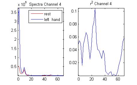

from the left vs rest r square figure, channel 4 (C4) around 26HZ has max R square, but from the spectra figure, the max spectra is around 10 HZ;
jane1985
- Posts: 16
- Joined: 04 Jan 2011, 09:44

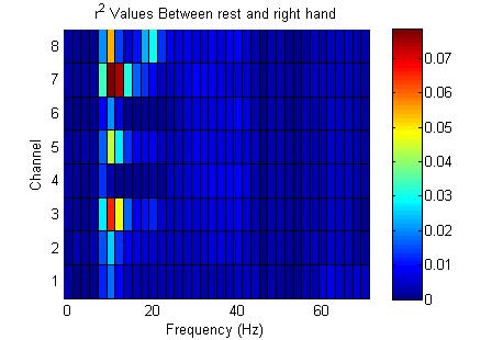

from the rest vs right R square figure, channel 6(CP3) around 22 Hz has max R square, but from the spectra figure, around 10Hz has max spectra value;
why the frequencies of R square and max spectra are not the same?
and from the above left vs right hand results which I posted several days before, the frequencies of max r square and max pectral are 10Hz, and the channels are FC3 and FC4. Why the results are not consistent with the " rest vs right hand" and " rest vs left hand"? how to determine the channel and best frequecy to do online experiment?
r^2 values measure how well discrimination between two conditions is possible. Often, high amplitudes and large amplitude differences coincide with high r^2 values, but this need not be the case. If there are large amplitudes/differences and low r^2 values, this is typically due to noise at those frequencies. From your plots, it appears that you have a lot of low frequency noise. To get rid of that noise,why the frequencies of R square and max spectra are not the same?
1) try to get your impedances below 25kOhms,
2) use a high pass filter in your amplifier.
Why the results are not consistent with the " rest vs right hand" and " rest vs left hand"?Go for the highest r^2 value over all conditions. In the online experiment, use the condition that discriminates best, i.e. has the highest r^2 value, and the associated channel and frequency.how to determine the channel and best frequecy to do online experiment?
