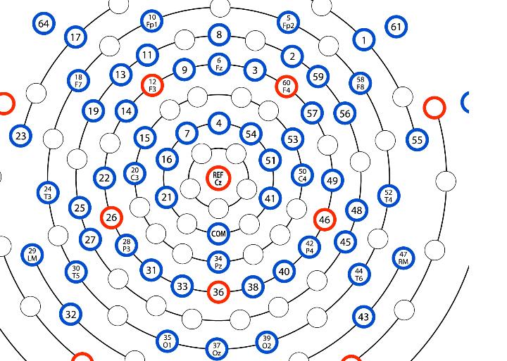

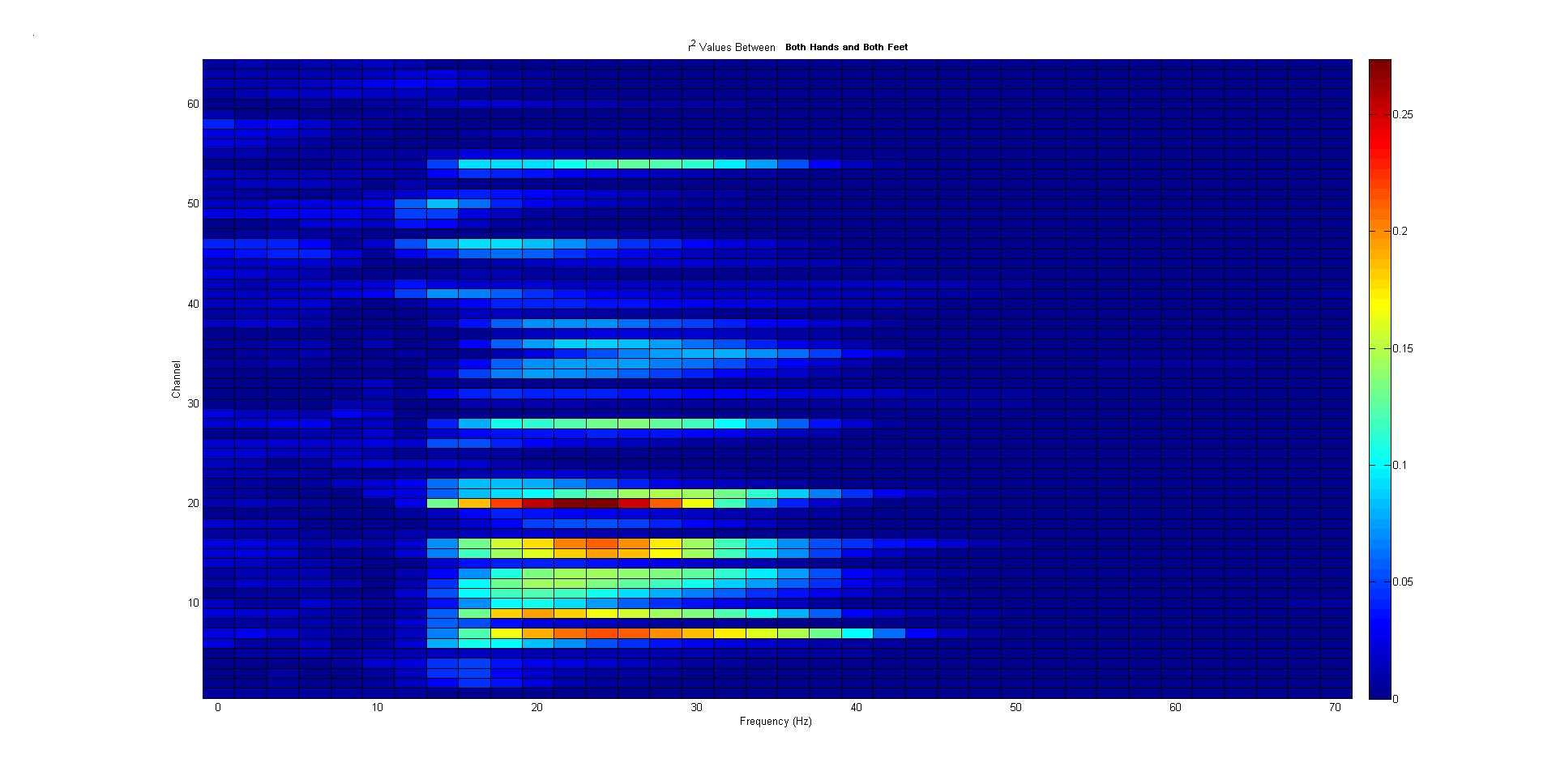

I am sorry to interrupt here, but I'm having a similar question. 30%,um, that is quite significant.
In my lab, we are using the 64-channel sensor net from EGI.
Unfortunately, Channel Cz is used as reference, so that I cannot get signal from it.
so can I use channel 4 or 34 instead (refer to the channel map below), if they have big r2 values?
One more thing I donot understand is, for 2D control, we are using C3 and REST to move cursor horizontally, using C3 and C4 together to move cursor up.
Channel C3 is used in both conditions, won't they interrup with each other? E.g. when we move the cursor up, the cursor will move to right too.

Re: no feet desynchronization
Hi Ran,
IIRC, in their 2D studies, Wolpaw and McFarland used orthogonal combinations, such as the sum of C3 and C4 at 12Hz for one direction, and the difference between C3 and C4 at 24Hz for the other direction.
you could use the negative average of the surrounding electrodes as an approximation to a Laplace-Filtered Cz. But of course you may use neighboring channels with large r^2 values as well, provided that you obtained the r^2 values from imagined feet movements.nfortunately, Channel Cz is used as reference, so that I cannot get signal from it.
