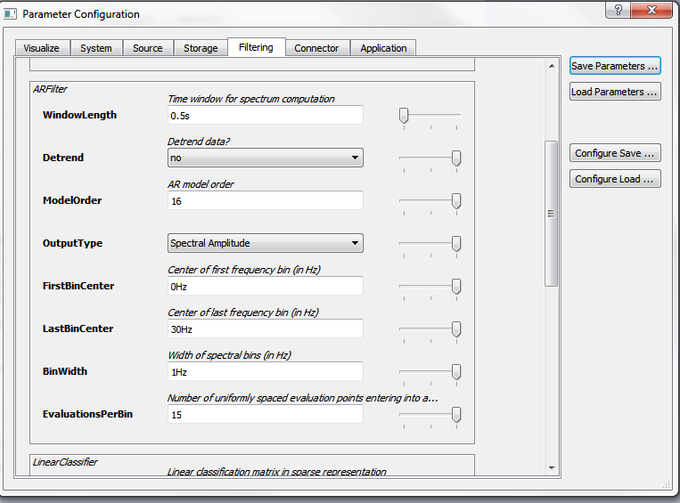

I'm sorry but still I can't get it. Let me try with an example. I have attached a snapshot of AR filter parameters' configuration. Let's assume that I want to use the same configuration in Matlab when calling the mem function. Would my parameters be:
Because sampleblock * numwindows = 256. That is equal to time window over which the AR filter operates expressed as number of samples. I'm sorry but I'm really missing something here.
Alessandro
I appreciated it.
sampfreq = 512;
ModelOrder= 16;
FirstBinCenter= 0;
LastBinCenter= 30;
BinWidth= 1;
EvaluationsPerBin= 15;
detrend = 0;
sampleblock = 16;
numwindows = 16;
Alessandro
Re: ARFilter Spectral Estimation
Dear Alessandro,
sorry for answering so late, it appears your post got lost.
Your configuration is right insofar as window size actually matches 0.5s.
Still, you need to decide on a reasonable sample block size because this parameter defines the interval in which spectra are computed. For each sample block, one spectrum is computed. This matches the behavior of the online system, which computes one spectrum for each sample block as well. So to use the same parameters as online, set the sample block size to the value of the Source->SampleBlockSize parameter in the online system.
Then, choose the "number of windows" parameter such that it matches 0.5s in terms of sample blocks.
