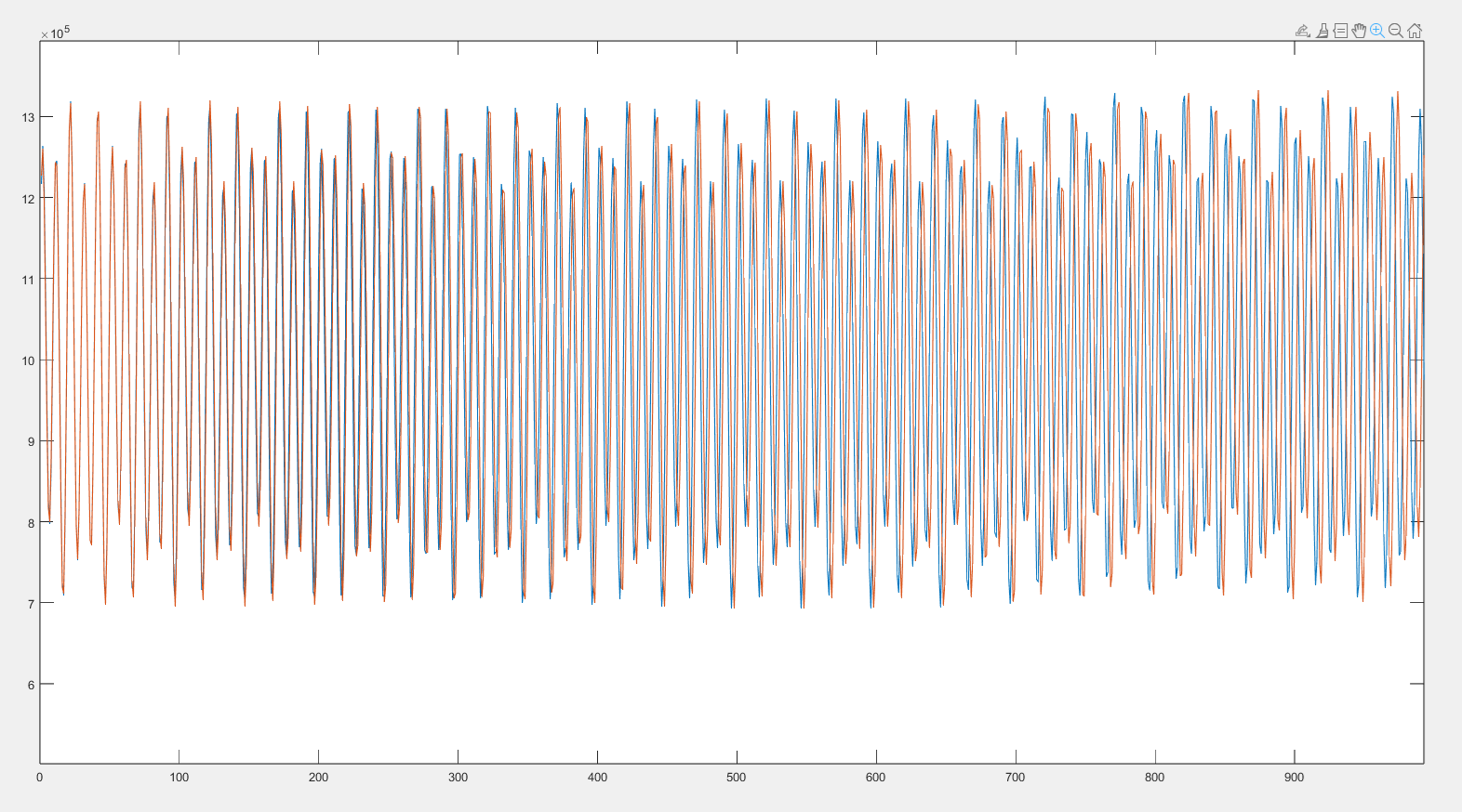

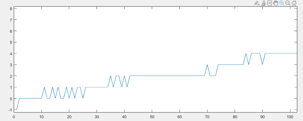

You can see in this image below we are recording a 100 Hz signal from channel 1 of each amplifier. The "faster" amplifier is the orange signal, which fits fewer 100Hz cycles into 1000 points of data. The second figure shows how the latency between cycle peaks changes over time. Over one second of data, the faster amp accumulates 4 additional samples in the buffer.

- 2sig.png (183.09 KiB) Viewed 92678 times
- delay.png (15.21 KiB) Viewed 92678 times
