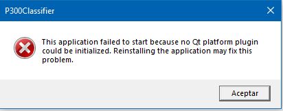

I tried to open the P300Classifier.exe file but it shows an error message:
"This application failed to start because no Qt platform plugin could be initialized."

- Error shown
- Captura.JPG (19.37 KiB) Viewed 33678 times

This is due to an error in P300Speller that was fixed in r6166.
I'm sorry that you experienced this issue.
We generally recommend to build BCI2000 from the latest SVN version as described here:
https://www.bci2000.org/mediawiki/index ... ng_BCI2000
If you would like to fix your version of BCI2000, you can go to the P300Speller directory, and move the "platforms" plugins directory out of the "qtplugins" directory into the "P300Speller" directory, such that "platforms" is a direct child of "P300Speller".
Note that this will not work with the "bundled" versions of BCI2000, as the plugins are located inside the bundle and cannot be moved.

Thank you, very much, Jürgen
That worked and now I can open the P3000Classifier.
Eduardo
