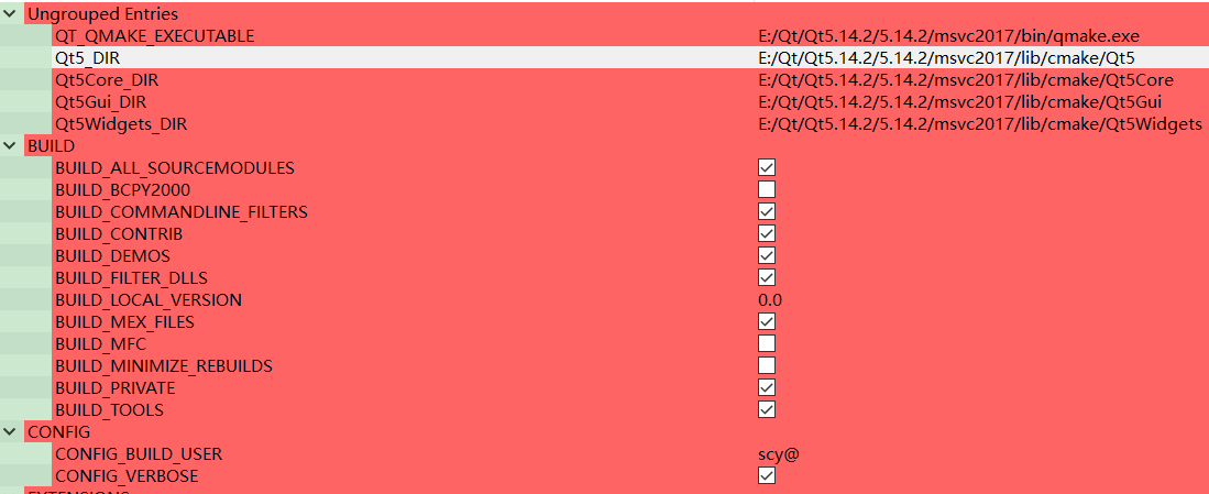

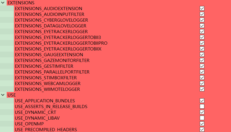

the following attachments are the configuration of CMake, I hope these will help.
download/file.php?mode=view&id=388
download/file.php?mode=view&id=389
as for the error message in cmd, I find it different this time : application initialization failed.

That probably means the program is missing a DLL it requires. Did you get any warning messages while building?as for the error message in cmd, I find it different this time : application initialization failed.
