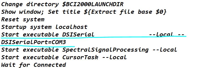

Three questions that should wrap things up for this thread:
1. The executable was verified to be valid. So the only thing we should do for cursor task is the following line of code after clicking edit (See the attached file called "QuestiononParameters.JPG"). Further down the code, what should be the line of code that should be used for the parameters? Should it be a line calling Mu Rhythm Feedback?
2. The only other thing that we then should do is add in the Mu Rhythm parameters using the Operator module using the GUI and change the electrode(s) and frequency to 6Hz (As discussed earlier in this thread), correct ? Does the headset need to be turned on when this happens? I ask because I cannot click config on the operator module since it is grey. Will the operator module automatically detect we are using the DSI headset?
This is all assuming we are not doing any sort of initial screening session. The final question is as follows:
3. So let's say we have the cursor task all loaded up. Is there is a way to turn off adaptation after 1 min or so? The documentation talked about setting the adaptation to 1 later in the program. Is this related to what I am asking about turning off adaptation after 1 min of feedback? If so, does it get set to 1 manually or automatically?
Thank you for your help thus far and for your detailed replies. You really do care a lot for BCI2000 and the community really appreciates it.
Thank you,
Mohammad
Thank you,
Mohammad
- QuestiononParameters.JPG (62.54 KiB) Viewed 89527 times
Re: A Theta Power Band Controlled 1D Cursor Task-Parameter Questions
Looks OK.1. The executable was verified to be valid. So the only thing we should do for cursor task is the following line of code after clicking edit (See the attached file called "QuestiononParameters.JPG").
It should be a LOAD PARAMETERFILE statement that loads your own parameter file. You create your own parameter file by clicking CONFIG in the Operator module, then use the "Load parameters..." button to load the mu rhythm parameter file, then use the parameter GUI to modify parameters, then use the "Save parameters..." button to save modified parameters under whatever name. Then load this file from the LOAD PARAMETERFILE statement.Further down the code, what should be the line of code that should be used for the parameters? Should it be a line calling Mu Rhythm Feedback?
It should not be grey. How did you "validate" your DSI executable?I ask because I cannot click config on the operator module since it is grey.
There is no way to do this from BCI2000 parameters, but you can write a script that starts BCI2000, waits for a minute, stops BCI2000, modfies the adaptation parameter, and starts BCI2000 again. I can help you write that script once you have everything else sorted out.Is there is a way to turn off adaptation after 1 min or so?
There is no such error message in the Normalizer filter. Which version of BCI2000 are you running?we get an error saying adaptation doesn't have enough input electrodes
In case the error message is "The number of entries in the Adaptation parameter must match the number of input channels", then you have a problem with the LinearClassifier (parameter "Classifier"). In the "Output Channel" entry, you need to have at least one entry with a "2". Please read the documentation of the LinearClassifier filter here:
https://www.bci2000.org/mediawiki/index ... Classifier
