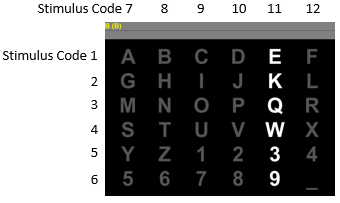

I want to change the stimulus presentation paradigm of P300speller.
I want to change the row and column paradigm that is currently set.
I understand the row and column paradigm is a set as shown in Fig. 1.
I'd like to flash the character group is not a row and column,
how do I change the character that is assigned to each of the stimulus code ?

- Fig. 1
- row and column StimulusCode.PNG (14.61 KiB) Viewed 42204 times

I assume that you want to flash random sets of N or M characters in an NxM sized matrix. Let me first check if I conceptually understand what you want to do:
Conceptually what you do is having a virtual NxM matrix that is a scrambled version of the original NxM matrix. For example if your original spelling matrix would be A, B, C, D, etc. you would have something like D, M, U, V etc. Each element of this virtual matrix is mapped to an element of your original matrix on the screen. You then logically always present a row (i.e., N characters) or column (i.e., M characters) of the virtual matrix which results in a seemingly random set of characters in the original matrix. Just a few conceptual caveats. When you do this you might want to consider creating stimulation sequences that optimize the hamming distance in the code that you present. There are several papers that show how to perform this properly. Further you don't really need a row-column presentation of the original matrix anymore, i.e, you could present any physical interface that you like, e.g., a QERTY keyboard style.
Let me know if this is what you would like to accomplish then I will expand on how to implement this in BCI2000.
