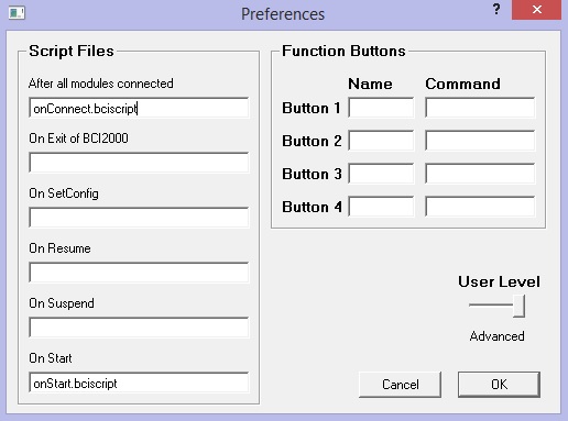

I'm trying to make a script for my EEG records using BCI2000. I'm following the instructions in the wiki; however, I get several errors. In order to understand the syntax, I tried the examples of the wiki.
I attached the jpg screen shot of the preferences dialog, so you can see how I configured it. The onConnect.bciscript works fine, this is the content of the script:

I tried with other examples of the wiki and I also get this errors. Basically, what I want to do with my script is to detect an specific stimulus (using the stimulusCode state) and suspend the run, until the subject clicks a key and then resume the run, something like this:
