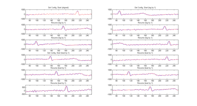

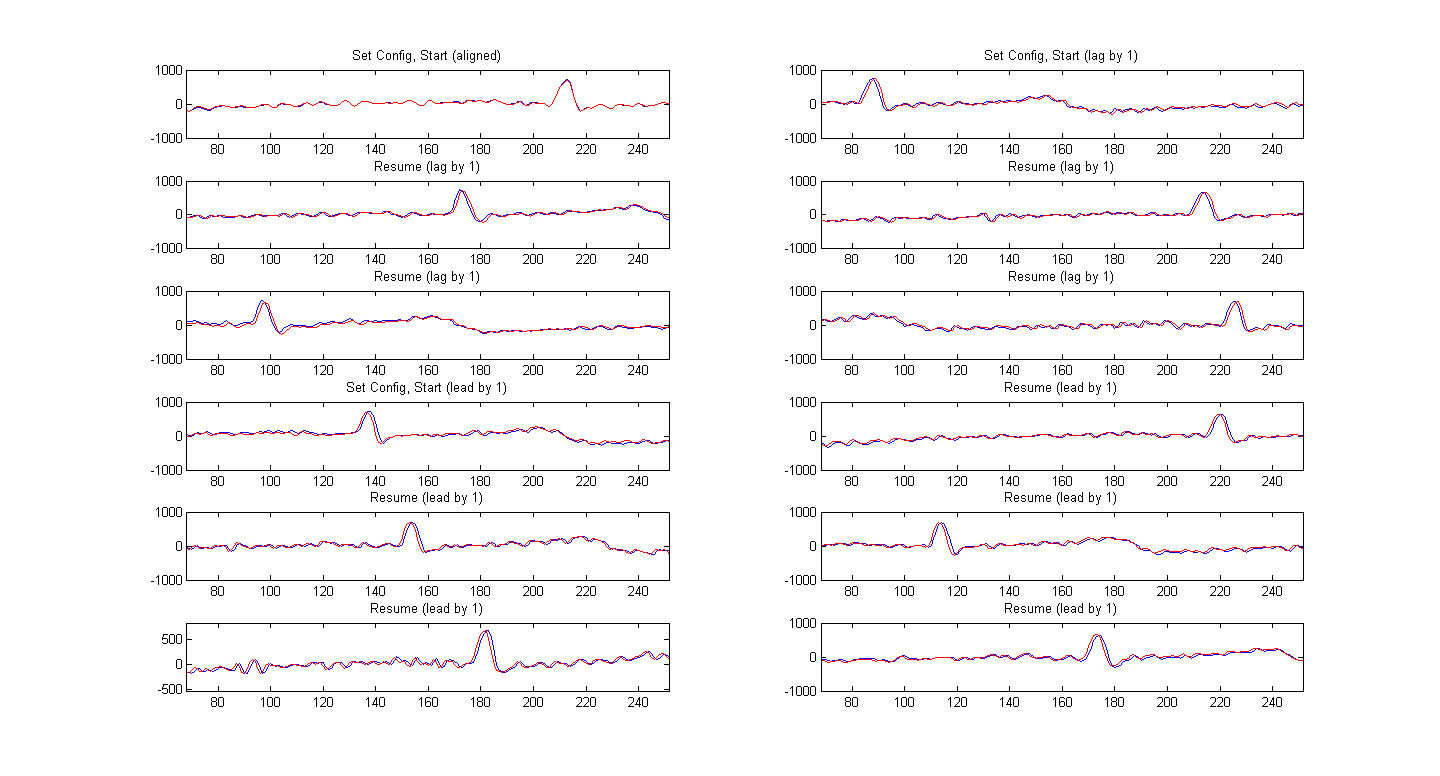

I recorded my heartbeat to demonstrate the problem. Channel one (blue line) is from channel 1 of the master amp. Channel 2 (red line) is from channel 5 of the slave amp (#21 overall). Both are recording from my left index finger referenced to my right index finger. 12 runs total.
Unless I press "Set Config" the (mis)alignment between amps stays the same in sequential runs. When I press "Set Config" there seems to be a random misalignment that is generated between the amps.
I dont think this is affected by my other issue (see: "Irregular Timing with 2 g.tec amps"), because the lag between amps is constant within runs as well.
