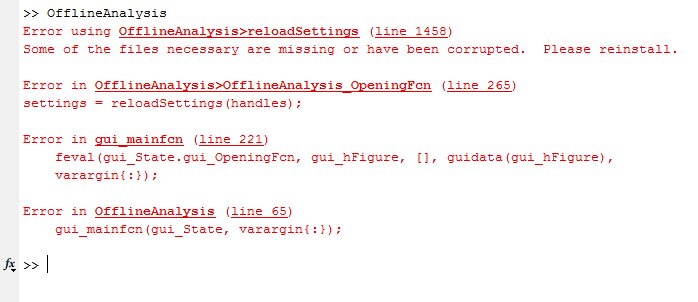

Post by krcn » 06 Dec 2011, 02:37
When I try to run OfflineAnalysis the following error appears:
Can anybody tell me what I have to do?
Thank You!!!!

I found out that it works now with BCI2000-sourceCode files.
Before it I used the BCI executables. Why doesn't it work with the executables?
Re: Offline Analysis Tool doesn't work
Post by mellinger » 09 Jan 2012, 13:46
Because it's a bug that has been fixed in SVN since the executables were released the last time.

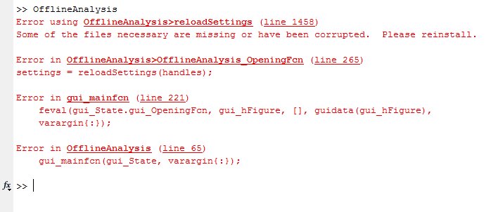

Post by antoniomaggiore » 29 Feb 2012, 11:04
I have the same problem, how you solved?
Post by mellinger » 03 Mar 2012, 10:07
OfflineAnalysis should now work again. There was a problem that has been fixed in r3853.
