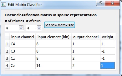

I’m working on the cursor task application trying to correctly configure my parameters but I have many issues.
I’m using a 16 electrodes configuration, following the 10-20 convention; my amplifier is the v-amp (brain vision products http://www.brainproducts.com/productdetails.php?id=15); all the impedences are under 10KΩ (checked with ActiCAP Control).
After the offline analysis with the stimulus presentation, I found out the channels and the frequencies to set up the linear classifier: left hand channel C4 16Hz; right hand channels C3 16Hz + FC1 20 Hz; both hands channel Cz 16hz; feet channel Cz 28Hz.
About the filtering tab:
1. Should I list all the channels in the list of CAR output channels?
2. How should I set up the weights in the matrix classifier?
3. Which is the correct way to use 2 channels as the same input channel inside the matrix classifier?

I tried to follow what you suggested: so i started to configure my matrix classifier for left hand and then left hand vs. right hand.: C4 @18Hz weight +10, C3 @16Hz weight -15; i used the following buffer condition. The cursor movement toward left direction was good and fast but for the opposite direction was too slow, even if i increased the value of the weight the movement was the same slow. Then I used more frequencies for C3 in the matrix classifier:
C4 18Hz 1 10
C3 14Hz 1 -15
C3 16Hz 1 -15
C3 18Hz 1 -15
but nothing changed. Do you have any idea to solve this problem?
After I tried to define the matrix classifier for hands and feet with the following configuration:
C3 18Hz 2 -10
C4 18Hz 2 -10
Cz 28Hz 2 10
Why is there an error when I use C3+C4 in the same row?
After this trial i made the full matrix classifier in order to use the cursor task for the two directions movement but i still
didn't get good results, especially for the vertical cursor movement. Is it possible that the system makes confusion cause i use the same frequencies for C3 and C4 in both directions 1 and 2?

I'm not sure whether I understand your question. In each row, you specify one input channel, and one output channel. Using multiple rows, you can combine multiple input channels into one output channel.Why is there an error when I use C3+C4 in the same row?
You cannot expect good results in a 2D experiment unless you have trained your subject to successfully use each of the two control signals in 1D experiments.After this trial i made the full matrix classifier in order to use the cursor task for the two directions movement but i still
As long as your subject is able to control the sum of and the difference between C3 and C4 independently of each other, the system won't be confused. However, controlling two signals independently is quite difficult, and requires a lot of training. E.g., the subjects participating in this study:Is it possible that the system makes confusion cause i use the same frequencies for C3 and C4 in both directions 1 and 2?

It is not possible to configure the matrix in the following way?I'm not sure whether I understand your question. In each row, you specify one input channel, and one output channel. Using multiple rows, you can combine multiple input channels into one output channel.
The error is the following:
2011-09-07T12:55:31 - LinearClassifier: Preflight: Channel specification in Classifier(4,input channel)=C4+C3 is invalid.
Regards
Roberto
Re: Mu Cursor Task Configuration
No, it is not possible to enter C3+C4 as an input channel. Only existing channels may be specified as input channels. To combine channels C3 and C4, you need to provide a row that specifies C3 as an input channel, and an additional row that specifies C4 as an input channel, and use the same output channel in both rows.
