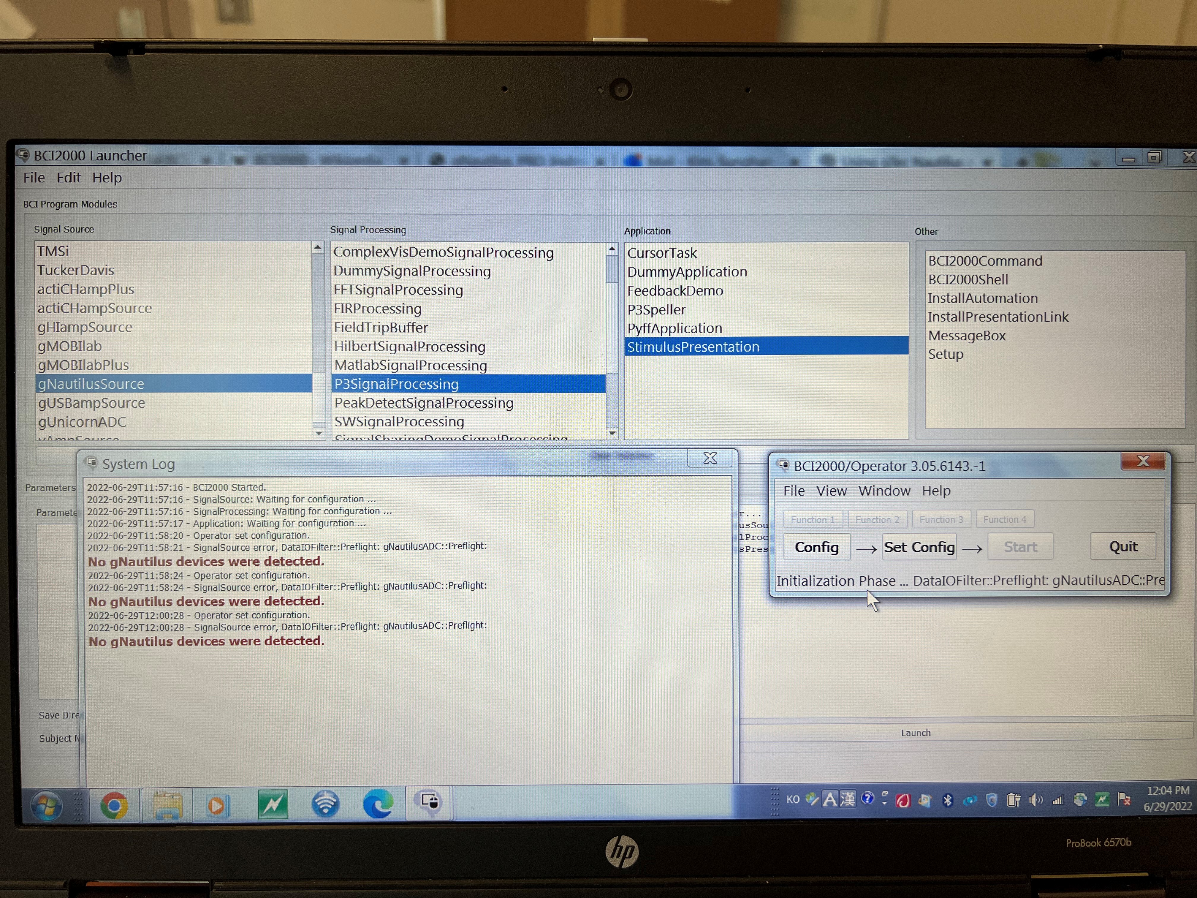

I have purchase a 64-channel Nautilus to record EEG using BCI2000.
After installing gNeedAccess successfully, my laptop does recognize the base station.
However, when I configure and run BCI2000 for a test drive, I am getting an error message as shown below:
"No gNautilus devices were detected."
Do you have any suggestion in terms of how to handle this error message?

Hi, you should be following instructions from here:
https://www.bci2000.org/mediawiki/index ... :gNautilus
There is a DeviceIDs parameter, which should be set to "auto" , and a DeviceIDMaster parameter, which should be set to "auto" as well.

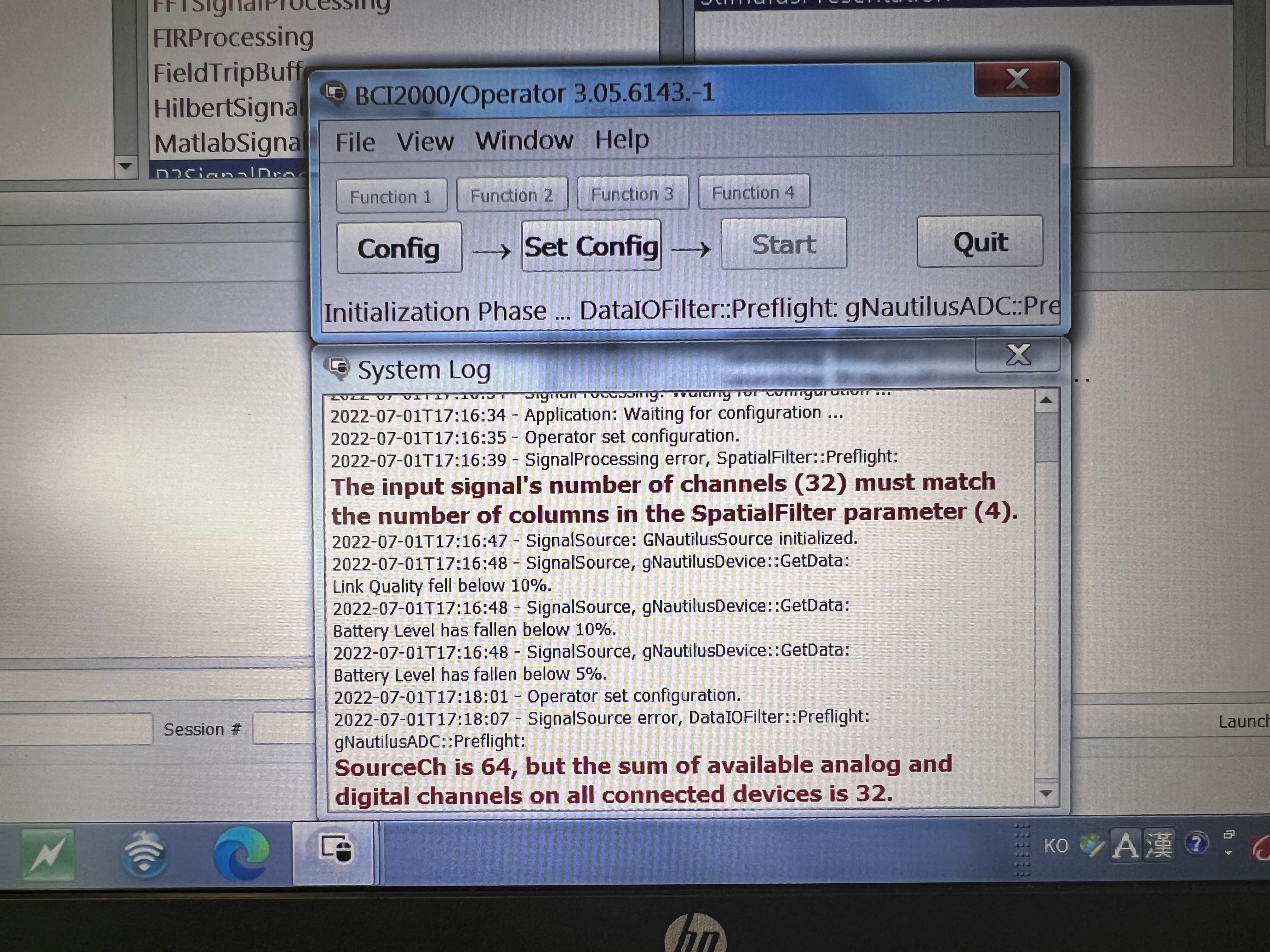

It was critical to remove four dll files from the "prog" folder of BCI2000.
They must interfere with the wireless communication between the Nautilus device and the base station.
Now, I have another error message.
It is about the number of channels that are available.
There are 64 electrodes installed on a cap. However, BCI2000 can only see 32 channels as shown below.
What could be causing this issue?
