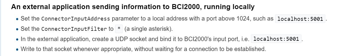

I read on the wiki there is this option (Please see attached Event MarkerQuestion.jpg). Is there more to this or is this the solution to our problem? If we do use the C++ or the Matlab implementation presented on the Wiki, how do we check the delay of our system?

Previous discussions on this forum said to look at the App Connector, but the wiki
(https://www.bci2000.org/mediawiki/index ... _Connector)
says it's superseded by other BCI2000 code, so if there is another wiki link it would help:

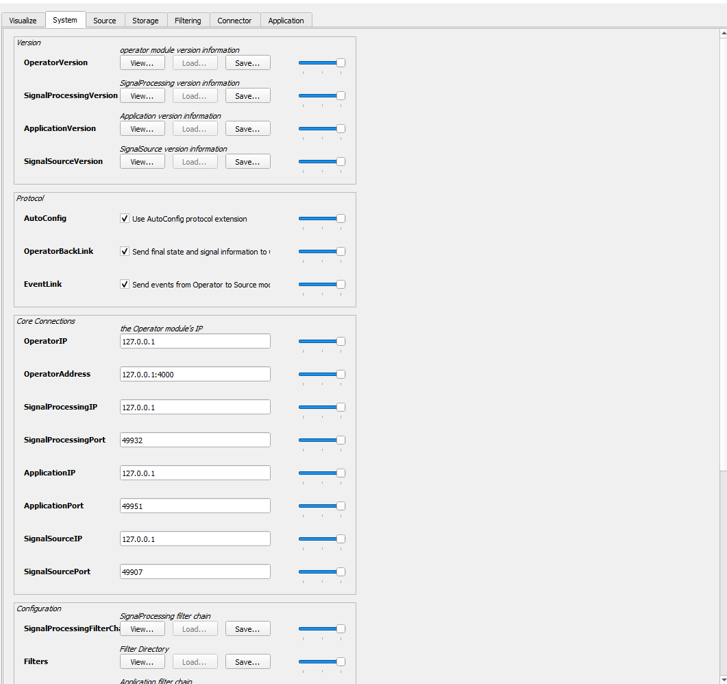

How do you know it doesn't have the EventLink component? In the Operator, check for presence of the System->EventLink parameter. If it is present, you have the EventLink component in the source module. Make sure it is enabled. Also, any recent build of BCI2000 should have it in all source modules. In case you received an outdated build of the DSISource module from DSI, you might consider switching to a more current one from the BCI2000 website.

There is an Eventlink component! Is there something I am doing wrong in the Matlab code in sending a signal I shared earlier in our discussion even after changing the CRLF command string as you suggested? Should I be using UDP instead of TCP/IP?

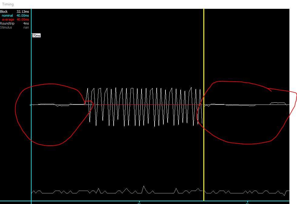

From this current setup, everything is done on the PC recording the data: The recording and the timing. Theoretically, would this mean that each trigger would not lead to a constant event marker each time an event occurs? Here is an example of what I mean:
If an event occurs at t=5s, the current set-up places a marker at 4.98 seconds Another event occurs at t=10s, and the current set-up places a marker at t=9.90s. Thus, the delays are not constant across these two events (0.02s vs 0.1s).
Thanks!
Sure, the Windows scheduler uses time slices of up to 20ms but typically timing is much better than that, as you may see in the BCI2000 timing window when considering the variance of block duration. If you need high precision trigger information, then you need to use the amplifier's digital inputs.

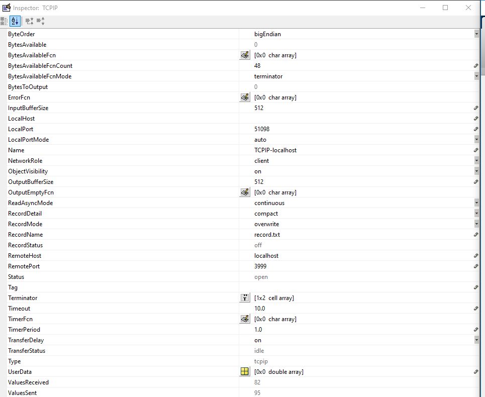

1. I have attached the fgetl() output (Titled TCPIPCheck).
2. When I have 'Pulse event Foo', there 's still no record of a "Foo" event occurring (No value of 1 in the event vector).
3. After doing more digging on the documentation, I tried to do 'Pulse event Foo 1' instead of 'Pulse event Foo': With the timings, window displayed and repeatedly running fprintf with an open socket, I occasionally get the following: Matlab will take a bit longer to run and a warning appears (Timeout2). Timeout1 shows a flat line during the time that Matlab takes to run. This effect is occasional, even when running the section in the code trying to fprintf. Is this something that is probably to be expected?
So it does seem the signal is, indeed, being sent by Matlab and, BCI2000 creates the event Foo.
The question is, why is Foo not being registered during the experiment? Is there something wrong with the way Foo is setup with the binwidth? Should we be using a UDP connection instead? I have been running this one section of code each time, independent of the device:
