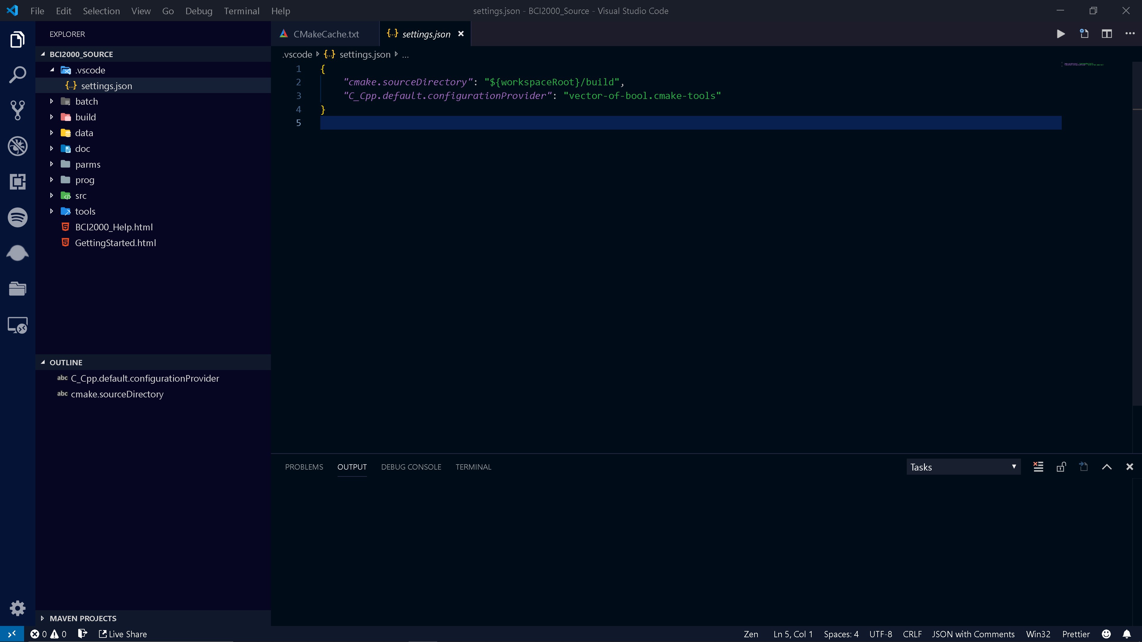

- Create a .vscode folder with a settings.json folder and add the following:

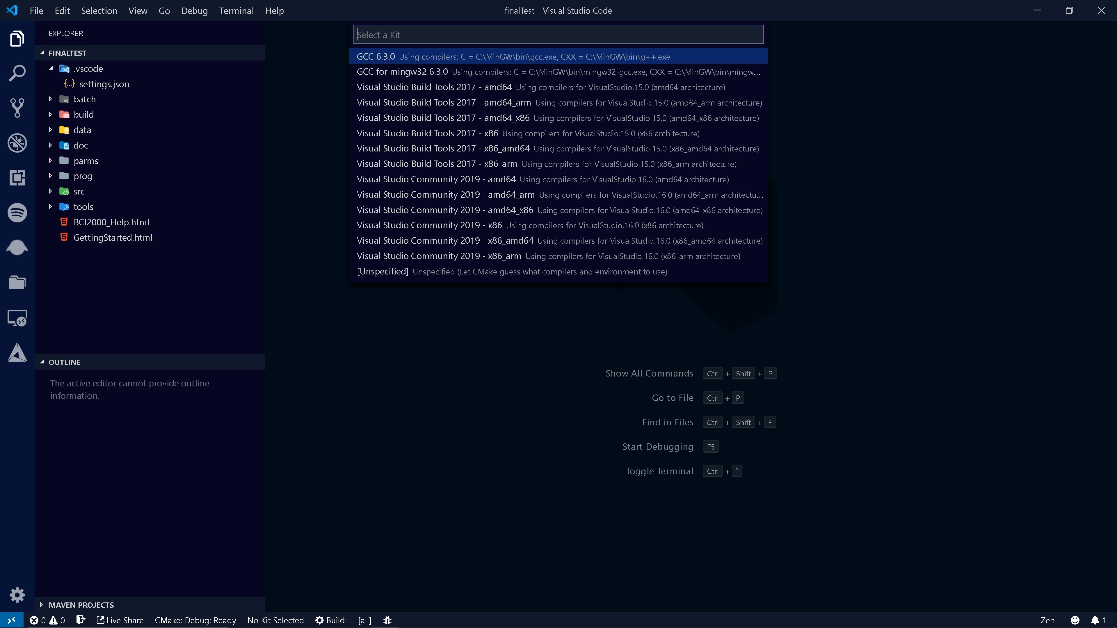

- Select a kit (Known to work for 2017/2019 x86_amd64):

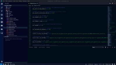

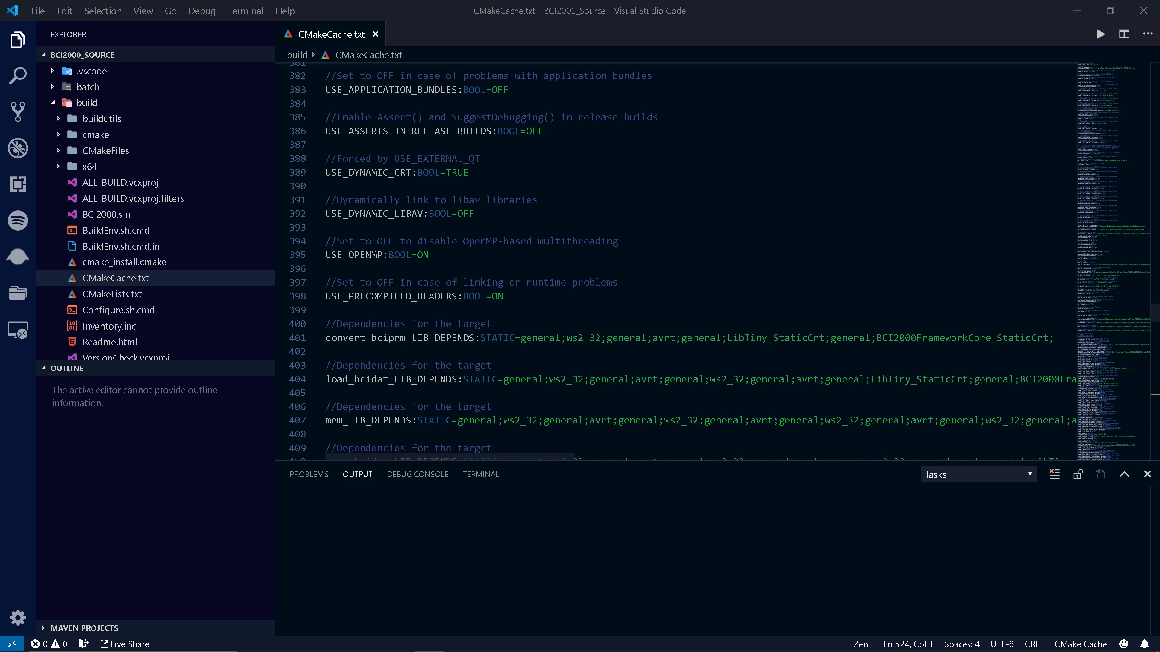

- Edit generated CMakeCache.txt file to your liking:

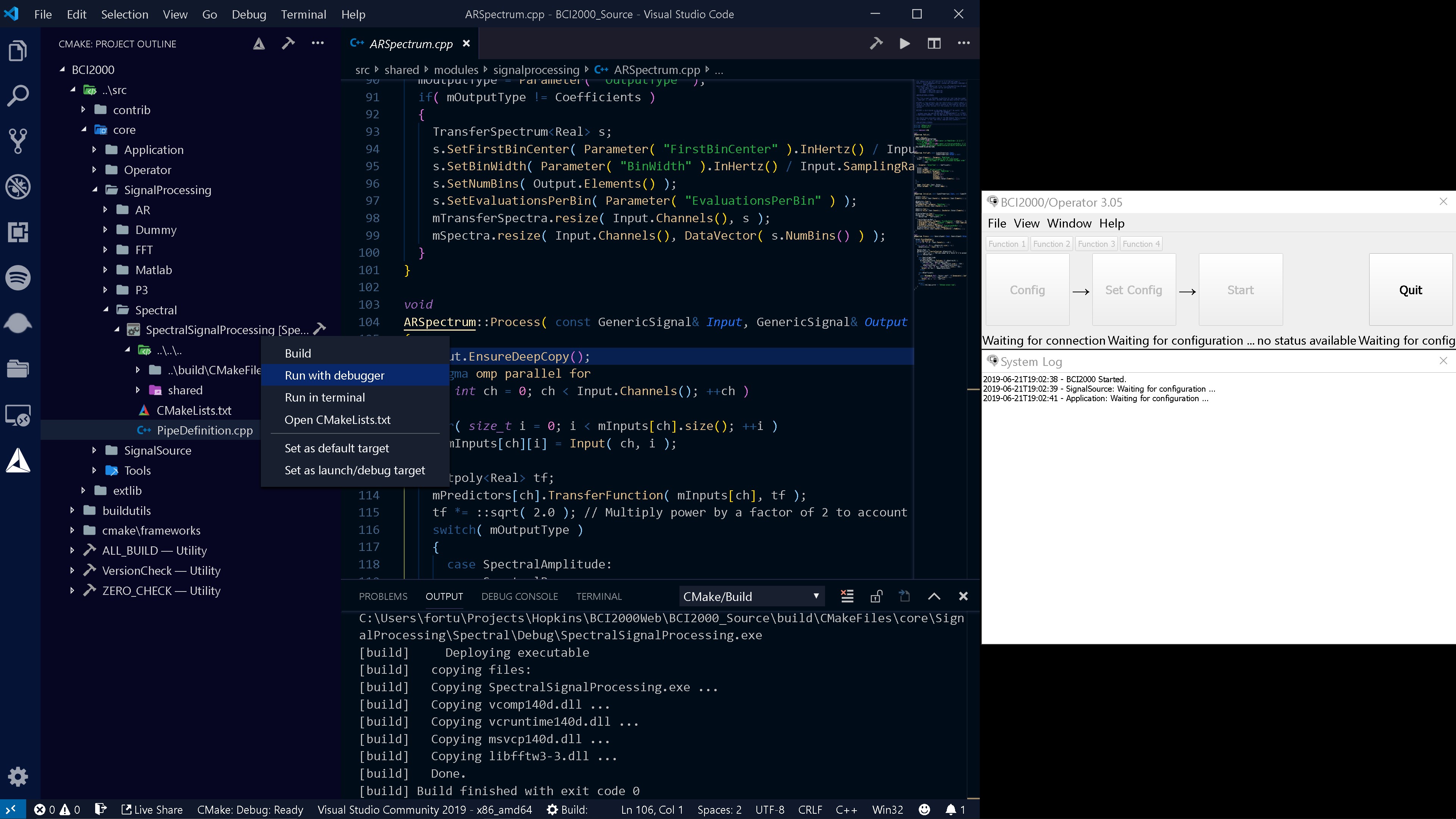

- Find the module you want to debug, right click and select "Run with debugger"

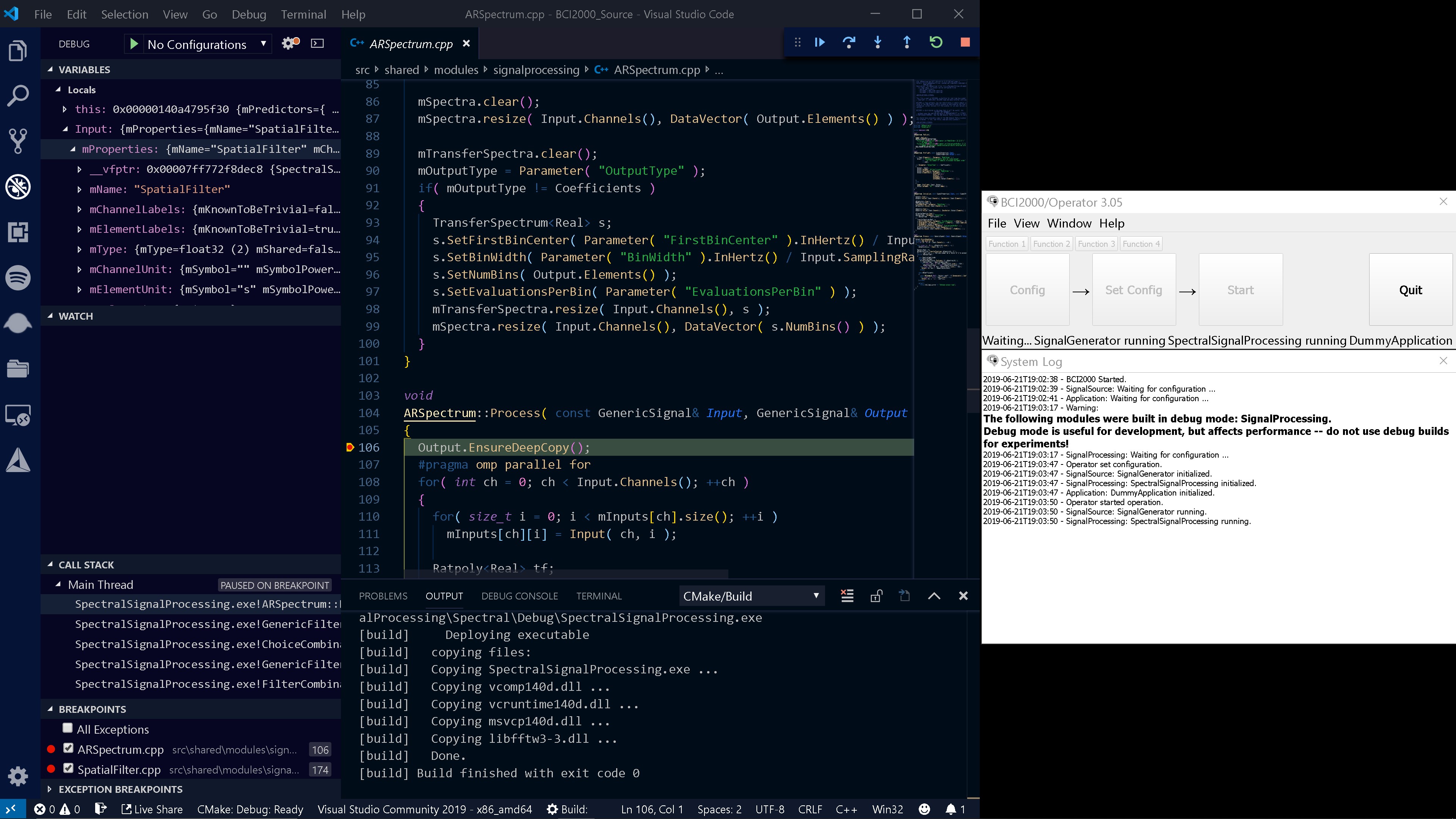

- Add a breakpoint and when it is reached the VSCode/C++ debugger should open up:
